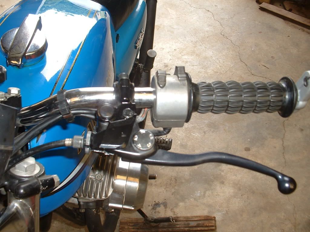

I put a EX 500 clutch perch on my S2A so it matched, and it works very nicely.

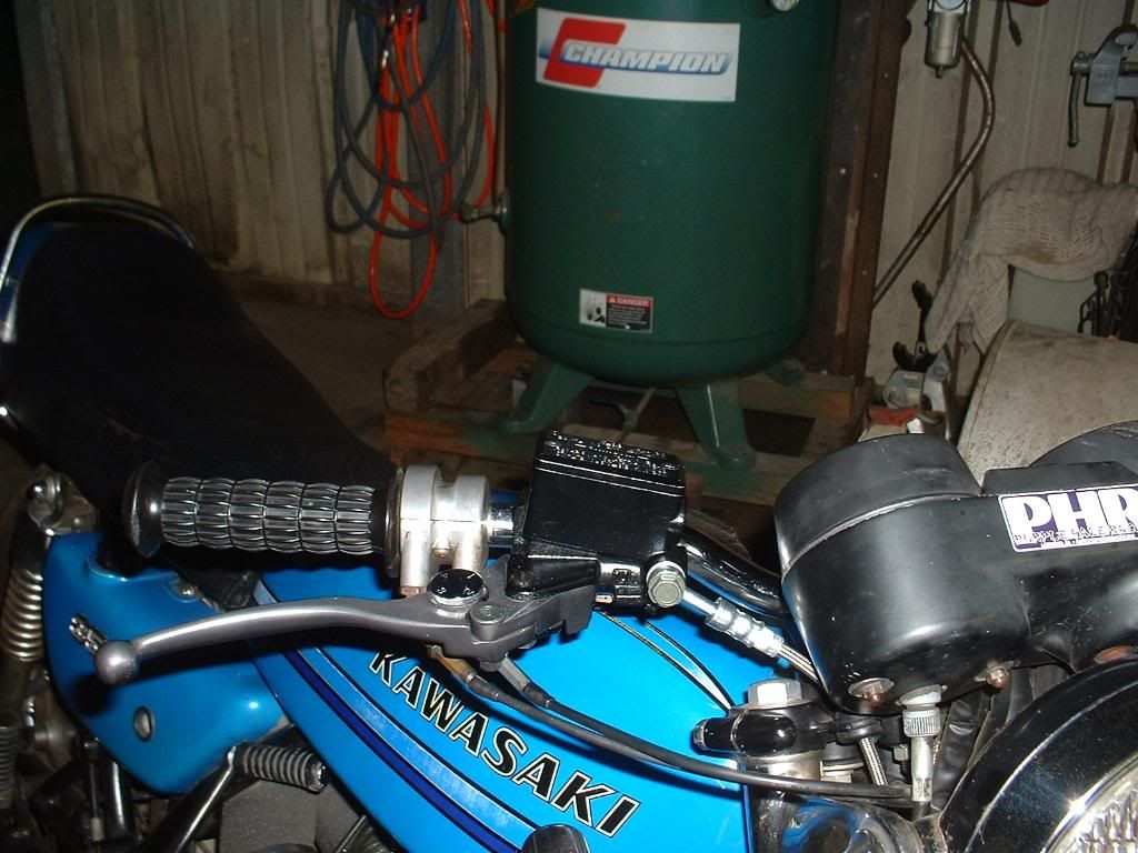

I still have the stock S3 clutch perch but I have a similar late model MC. The brake line on mine is Spiegler. I ordered it through a dealer to custom length. Best part about the Spiegler lines - rotating ends instead of fixed.
