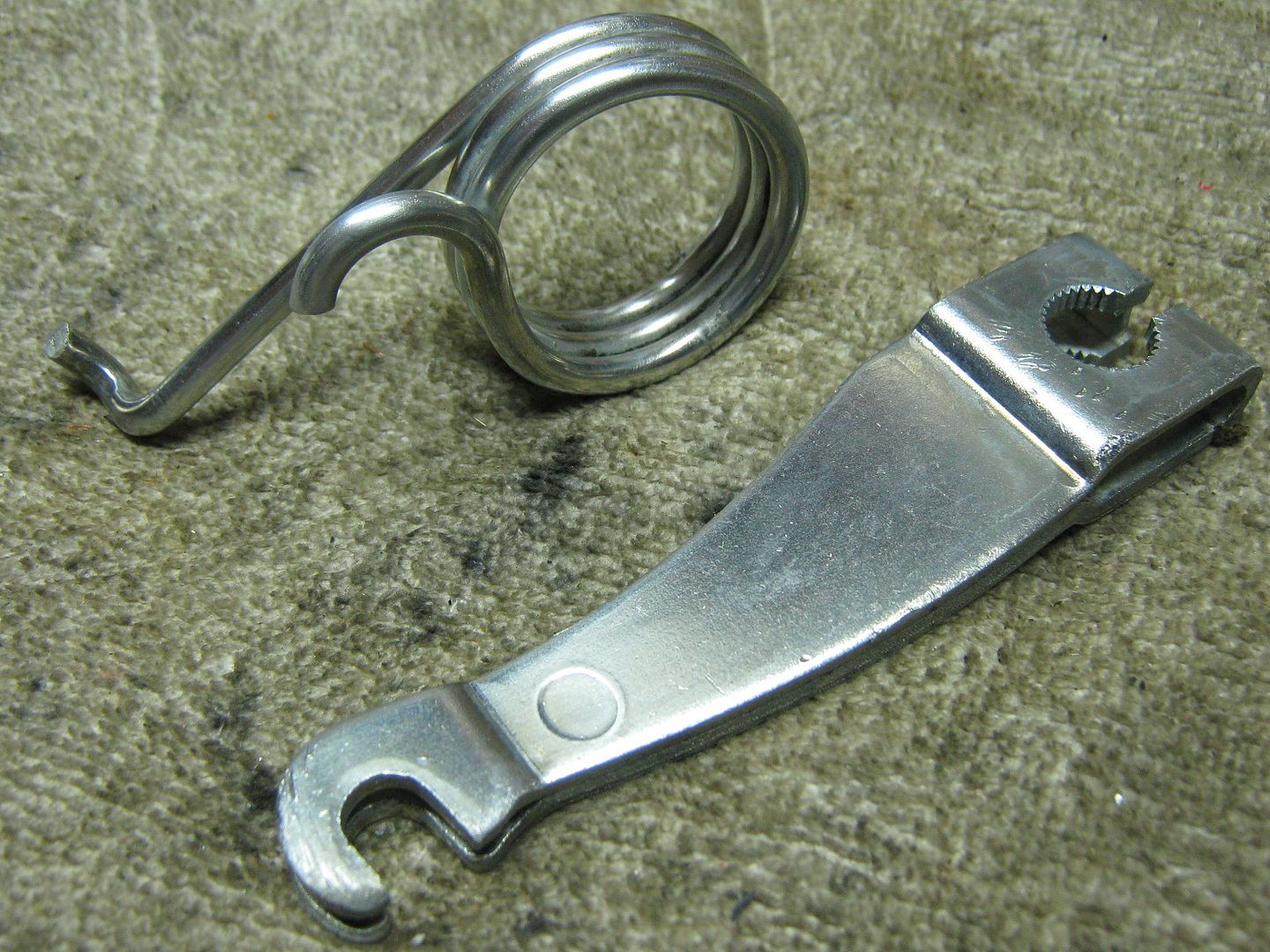

I finally got all the stuff lined up today and got set up and plated two pieces. Here is the brake lever spring and the front brake arm. I think they turned out real well.
The rear brake arm is NOS.
Here is what the spring looked like before cleanup and plating.

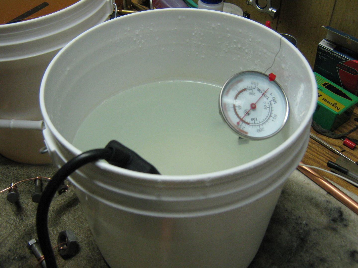

Here is some more of the setup, very crude and simple.
I bought the $45 titanium heater from Caswell. From room temperature it takes 30 to 45 minutes to heat the washing solution.
Here is the whole works. The pee looking stuff is the zinc bath. I heat the wash first to 170 degrees and then I heat the zinc bath to 120.

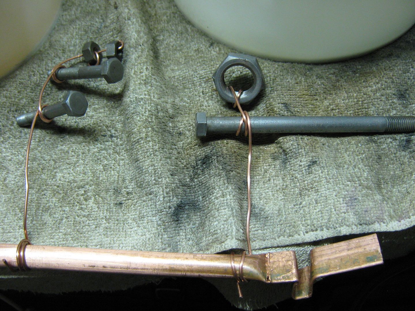

Here is how I tie the parts. I didn't read anywhere in the manual about what kind of wire to use to hang the parts on. The two I did last night I used extremely thin steel wire, thinner than piano wire. I found that if I didn't attach two of the wires to the piece being zinced the single wire would glow red. Today I am going to try solid copper wire.
