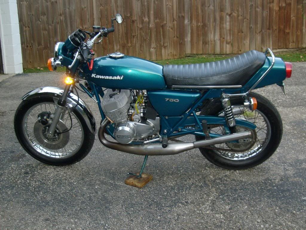

My tank looks like a 75 tank or the rare tank that some 74's had, either that or I have a compilation Bike as my frame is H2F385XX and the engine is H2E369XX......The engine should be higher numbered than the frame........Don't really care as it is a really nice, no rust, well stored and great running bike. I am doing a resto on it now trying to ID the tank as it is long and slender, will need to get the right decals from reproduction graphics........and I really want to paint it the 75 candy purple anyways. I am building a rider with some upgrades, not a bone stock resto show bike.

Looks to be an h2c tank.. whats up with your shocks ? Is this for better handling on left hand turns. :P :P

LOL...Thats my Sprint car\Nascar setup for going around in circles......We are Hillbillys in this region !

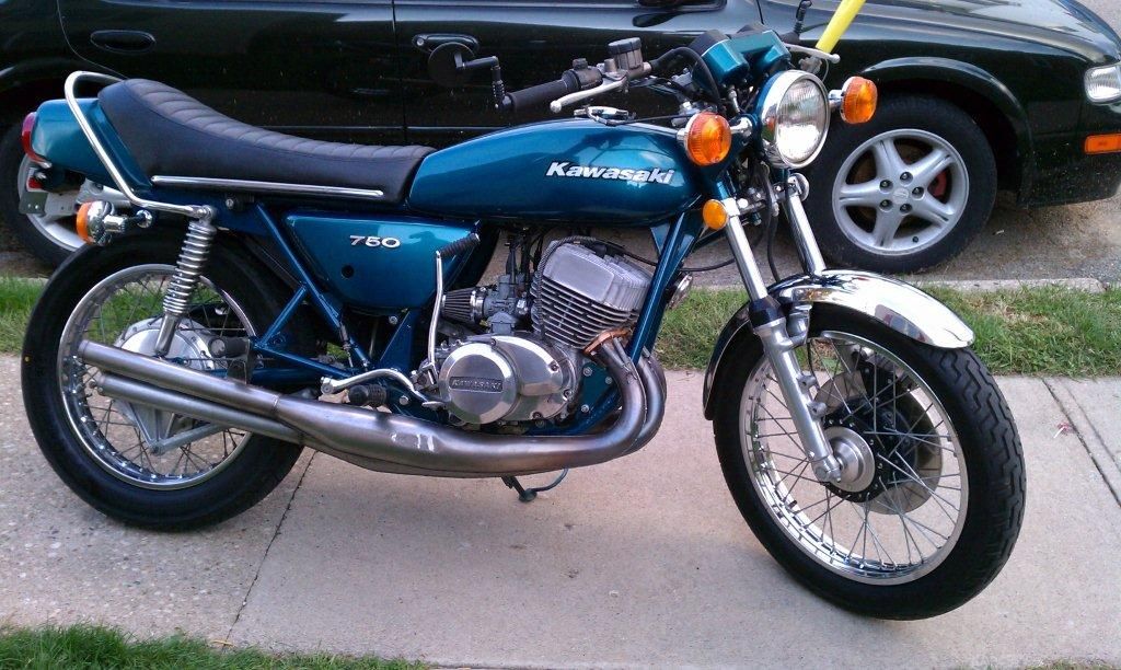

Actually the first picture is newer with the progressive 412 shocks and the VM34 carbs with UFO's
The second is the original when I got the bike this July, stock shocks and carbs.

It takes special rubber mounts to fit the 75 tank on a 74 frame. The 75 frame has the rubber biscuts mounted out wider than the 74. If you have the stock little rubber pucks something else is going on. It looks like a KZ tank to me.

Thanks for the info, I have two rubber dampers in the front, they look look like standard maybe 3/4' round rubber grommets, have the two that rap around the frame towards the back, its hard to tell what the tank it is...looks good on the bike in person....I want to order decals from reproduction graphics......hope its a 75 tank, anybody got any ideas let me know.

:eh: Nope, you are VERY wrong - the tank mounting system is absolutely identical on both bikes, obviously the C tank is an inch longer so the seat is an inch shorter, the "C" frame has a second pair of rear strap hooks and that is actually the easiest way to tell if you have a "B" or a "C" frame ;)

In my first post, the serial number of my frame is F38XXX, I have a 74 frame and it does not have an extra set of tangs or hooks at the back of the tank (just 2), I also noticed that the paint on the tank seems to have been rubbed by the seat a bit, even though it does not look like the seat is bunched up or goofey looking. I think they may have wrecked it at some point and put a 75 tank on it. Also, it does not have a factory tank strap, they used a thin bungy type cord.......the frame is at the powder coaters now, but it seems the tank may be longer than where the hooks are. I am assuming it is a 75 tank, I just ordered 75 purple graphics from reproduction decals today.....I know it won't be period correct, but I am doing many mods to it anyway.

They probably swapped out the seat also with a 75 .. Hopefully your fork ears survived and can be rechromed... I used to prefer the h2c over the h2b But over time ive come to prefer the h2b.. could be in part that green is one of my favorite kawi colors..As for the seat rubbing.. thats the norm once its been sat upon..If it were my bike.. I'd toss those chambers and go with something a little more aesthetic to the eye.. But again thats one's preference!! ;)

RB, surely there's also the small matter that the H2-C has the steering damper mounted on the other side of the frame???
