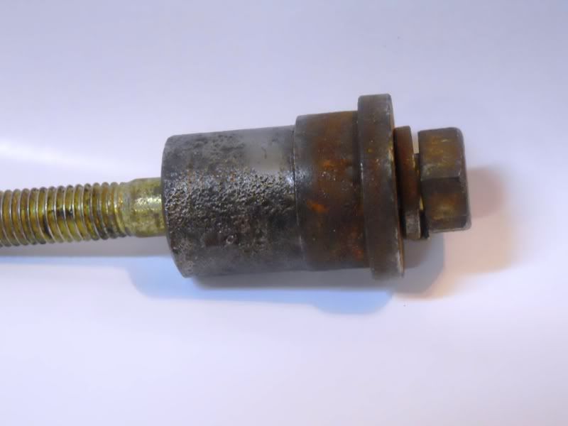

 Post subject: points cam problems

rusted cam
repaired

That is a problem :)

you sure thats the one ya got off me ??? WOW

Were those hardened? What material? That shouldn't be a difficult lathe project, maybe I could whip one up for testing...

no its not hardened just plain jane steel its the pin that is hardened. i would have repaired my own except the locating pin was snaped off flush and i couldn't drill it out. every one i have come across is rusted beyond usefullness. stainless ones would be nice.

I have a junk one as well, (sheered pin) good enough for getting dimensions, I'll see what I can do... :D
Yes stainless would be the ticket! Why do they need to be hardened? Doesn't seem like a lot of stress as the force is in compression and minimal - am I missing something? Also, I remember a recent post where a fix was using JB Weld then sanding smooth.

Could make them out of 4140 prehardened material as well...

i think nothing less then titanium will do :thumbup:
