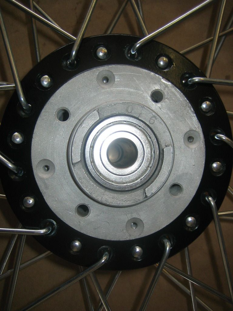

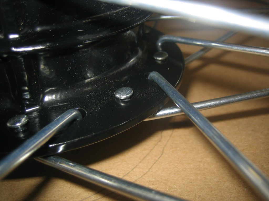

I don't have the proper spokes yet so I did a loose build (not fully tightened and trued) of the front wheel. The spokes fit very badly in the hub and the nipples are too small for the holes in the rim. Very shoddy looking to me.
Here are a couple of photos of the poor fit at the hub.
In this photo you can easily see the gap in the hole due to the undersized spoke diameter. Even the head size is too small
Looking at a side view you can see the fit up is pretty bad. Nothing lays correctly.
I did this build just to see if I could live with it. Answer: I can not live with this. I have standards - not many, but I have them. :lol:
