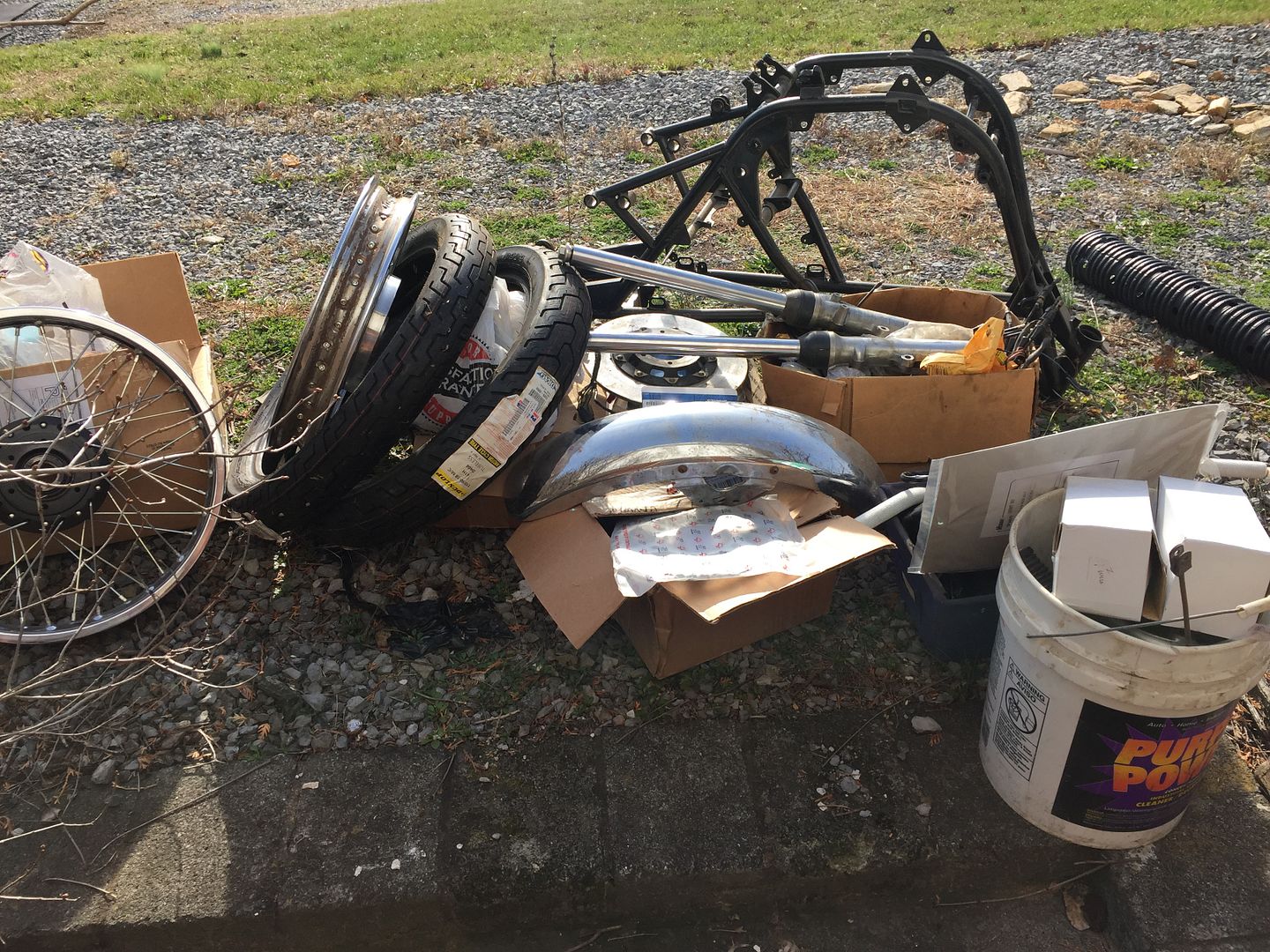

Here's what I started with.......buckets and a frame. ;) in this pic, some of the rebuild work is completed. The shocks and rims are done, frames been painted, ect.

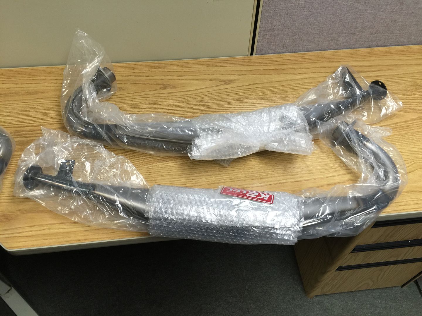

K2tek chambers. These were very nice and are out getting powder coated at the moment.

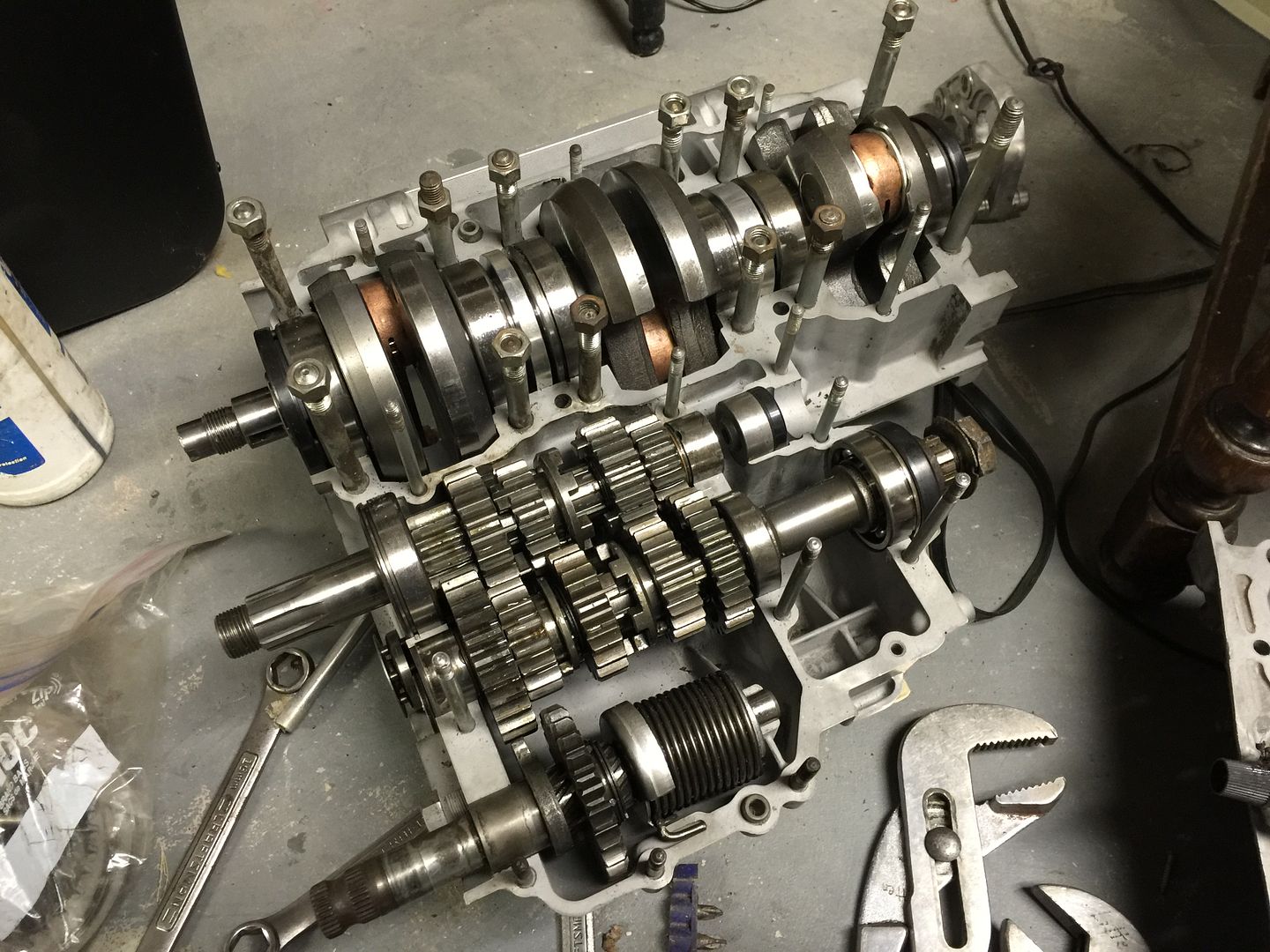

Charlie's crank with slotted rods, rebuilt tranny, all new bearings throughout.

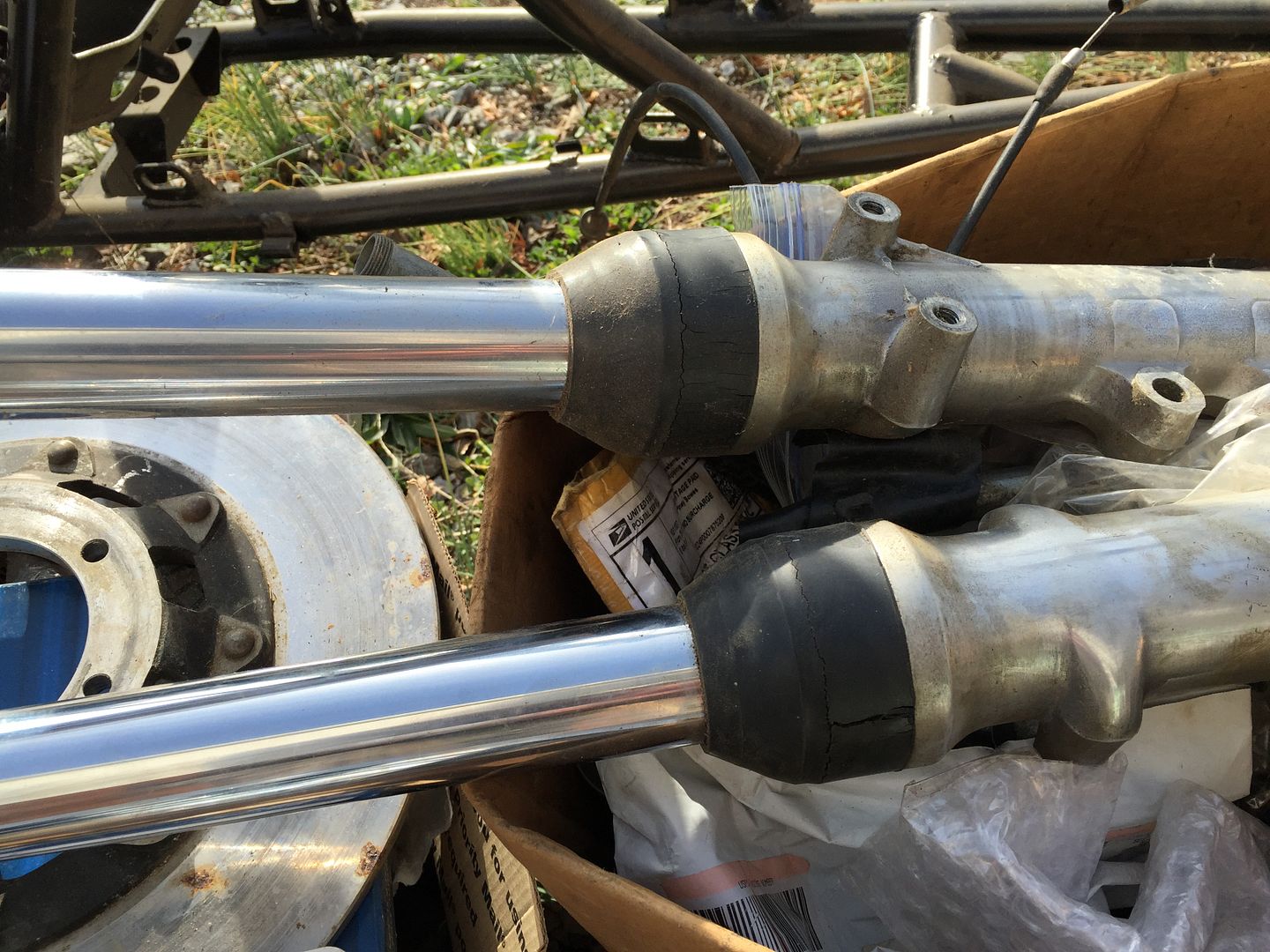

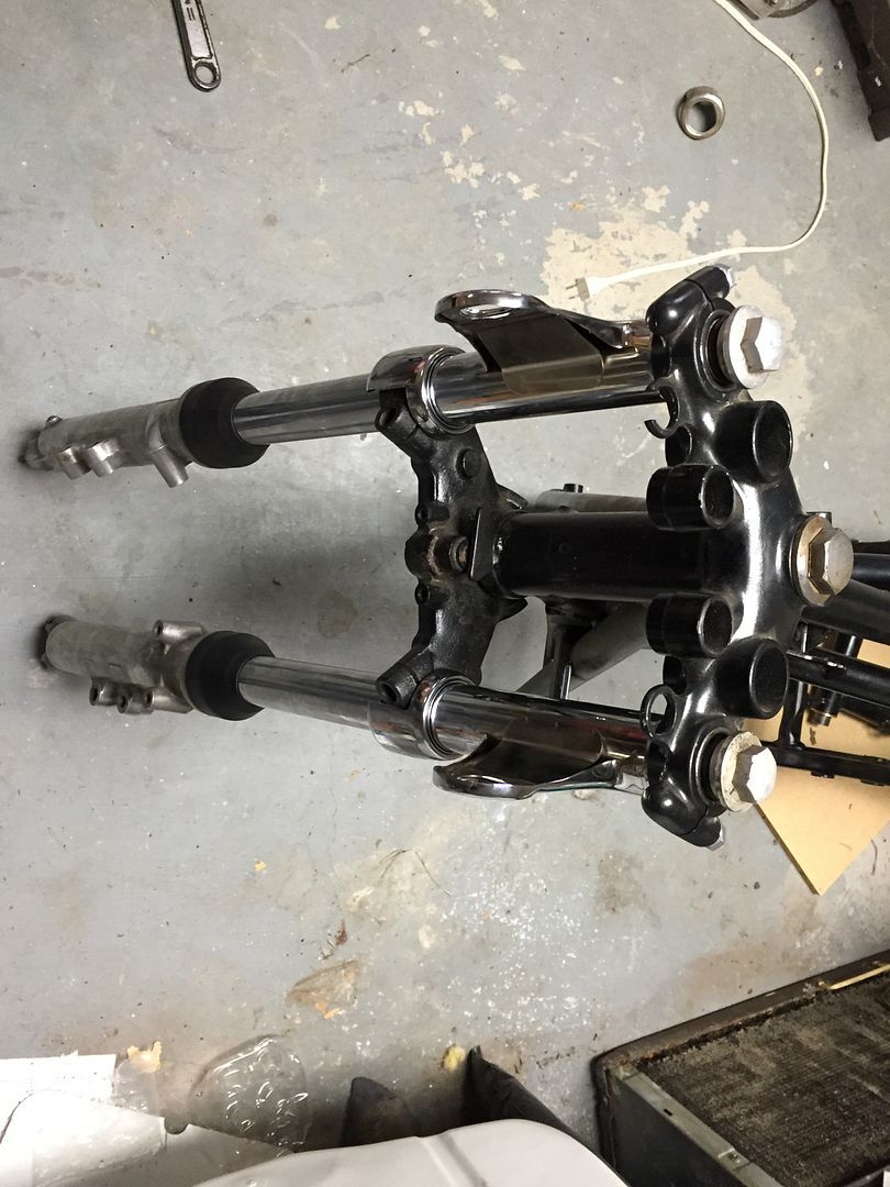

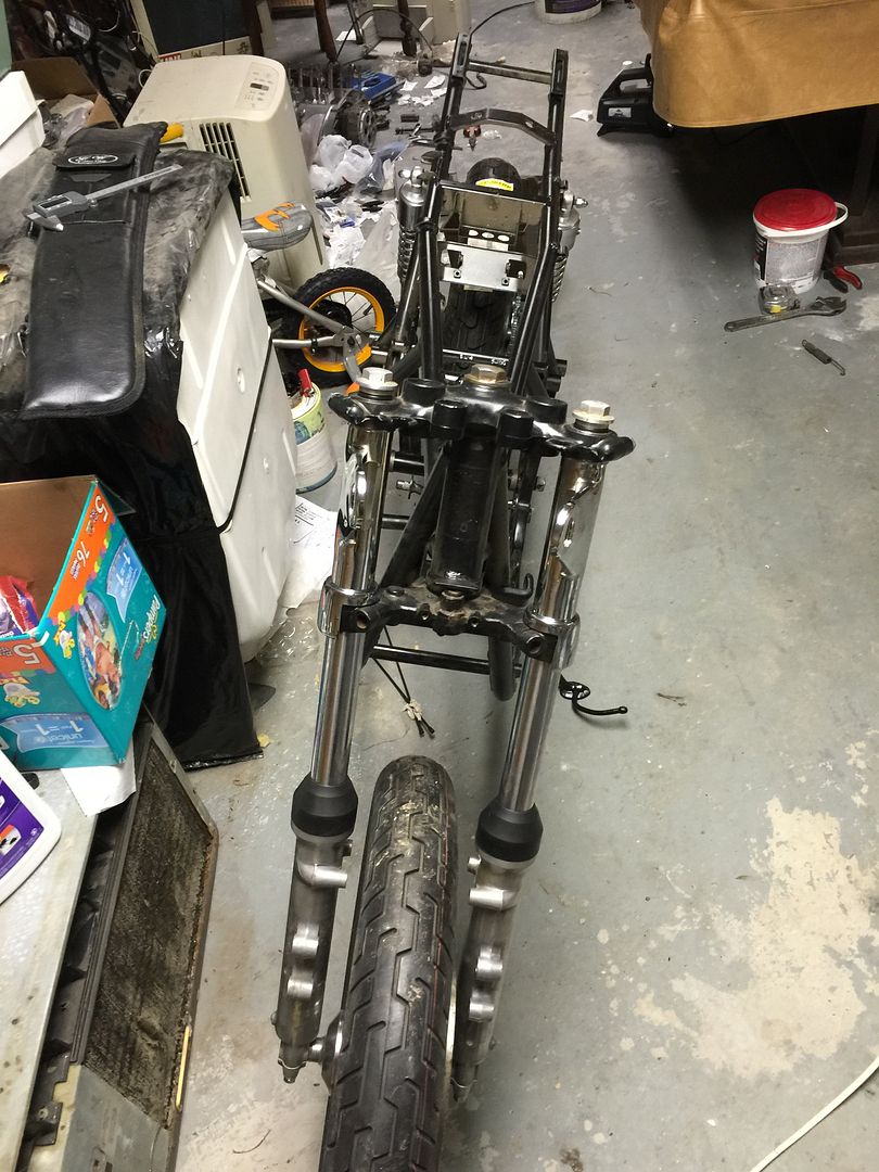

Front end assembly. New fork tubes and seals, z1 ears and trim hardware used, new head bearings. Since decent fork ears are unobtanium for this bike, I've opted for this. I wanted it to looks stock for the most part.

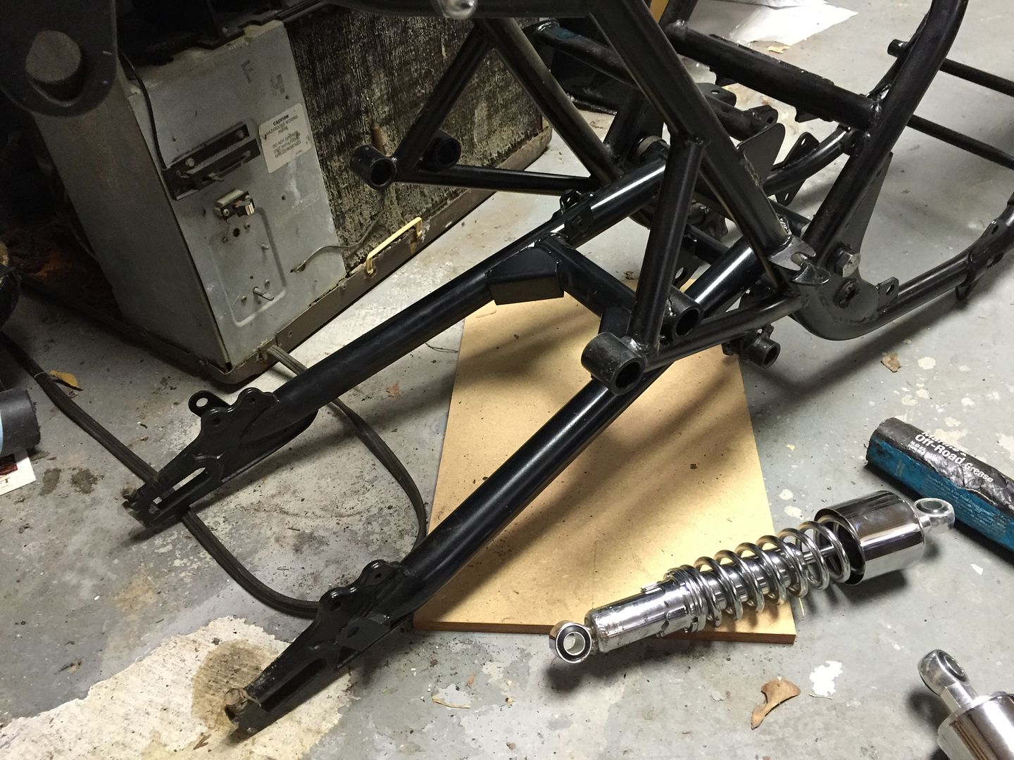

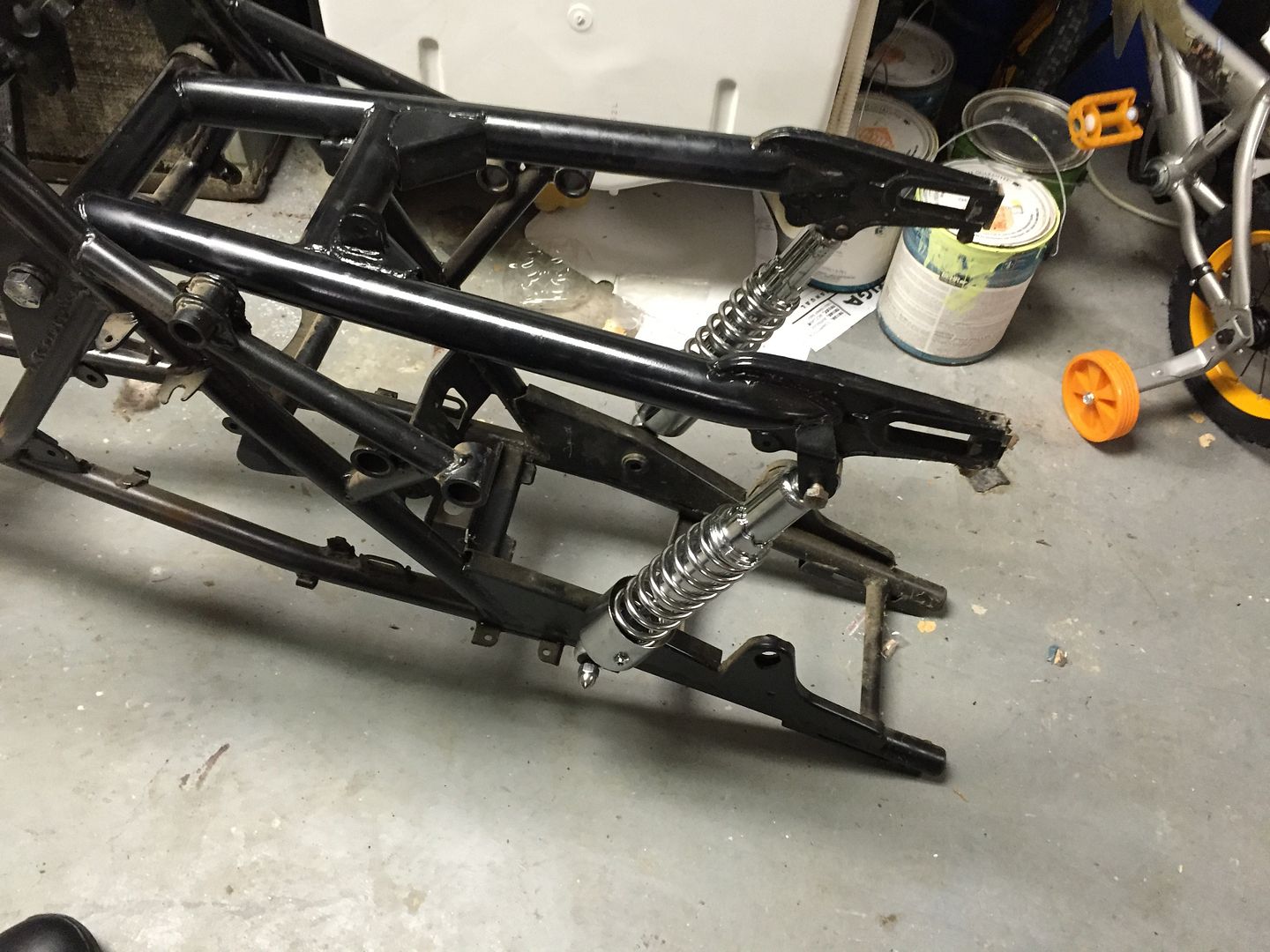

Swing arm has new bushings and new shocks from Jess. Bike had to be upside down so I could true the wheels and mount.

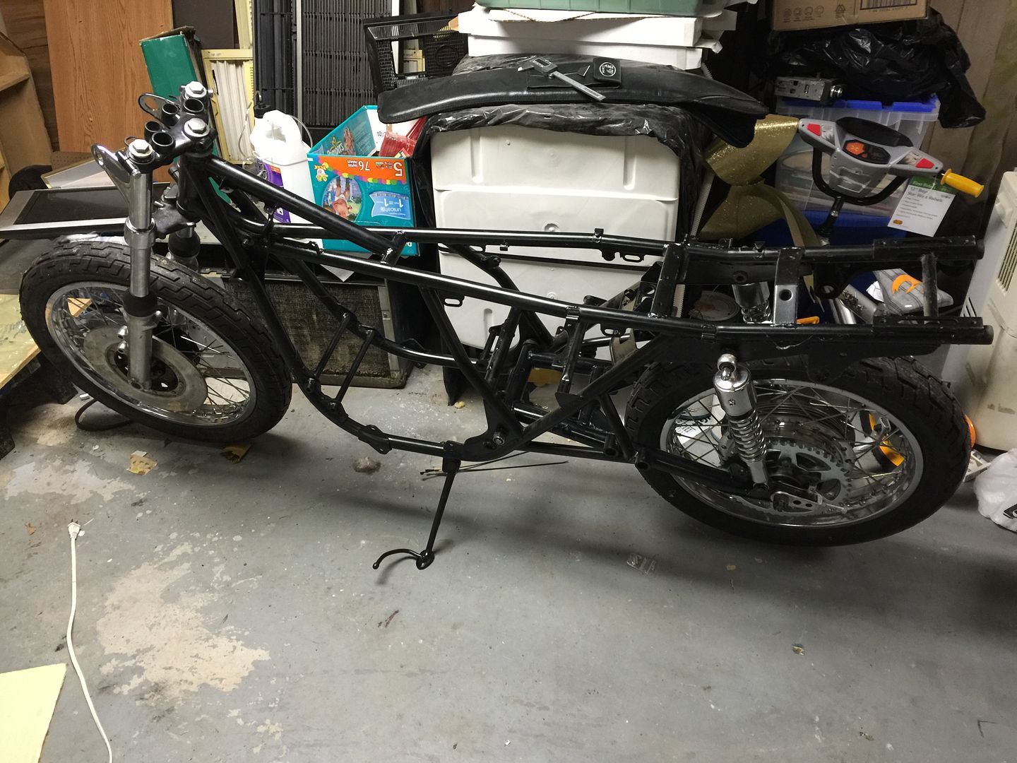

Wheels are now trued, tires are mounted and installed, and now it's right side up. Ignore the mess....my garages are full of bikes and lawn equipment and the storage area of the basement is he only place I can put it at the moment.
It don't look to bad I think. :thumbup:

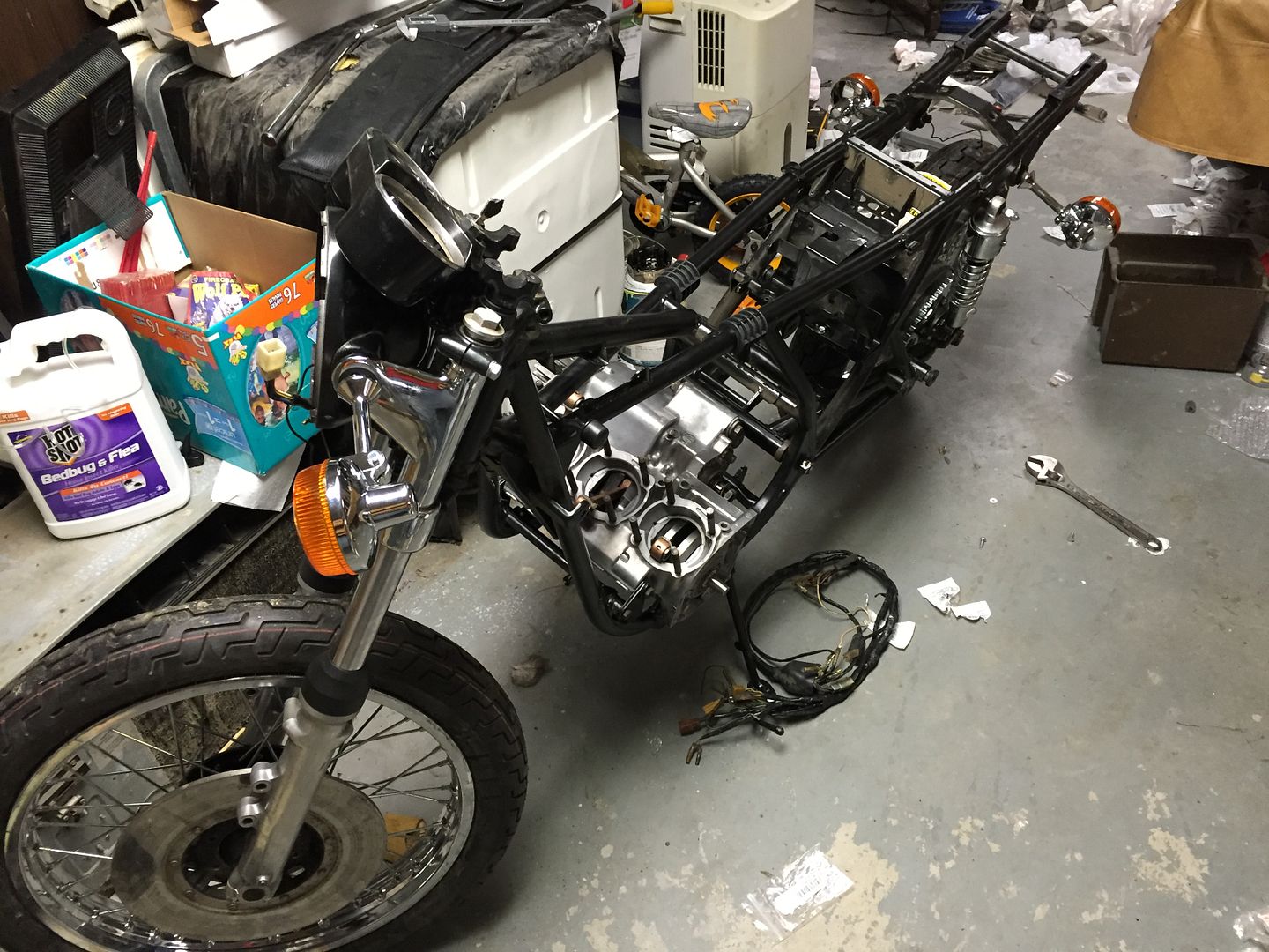

Engines mounted and some other things installed.
Engine looks good in there. :thumbup:

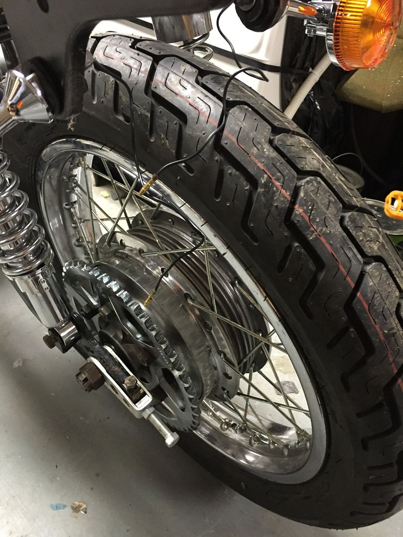

Wheel has new bearings, seals, shoes, spokes, and rubber.

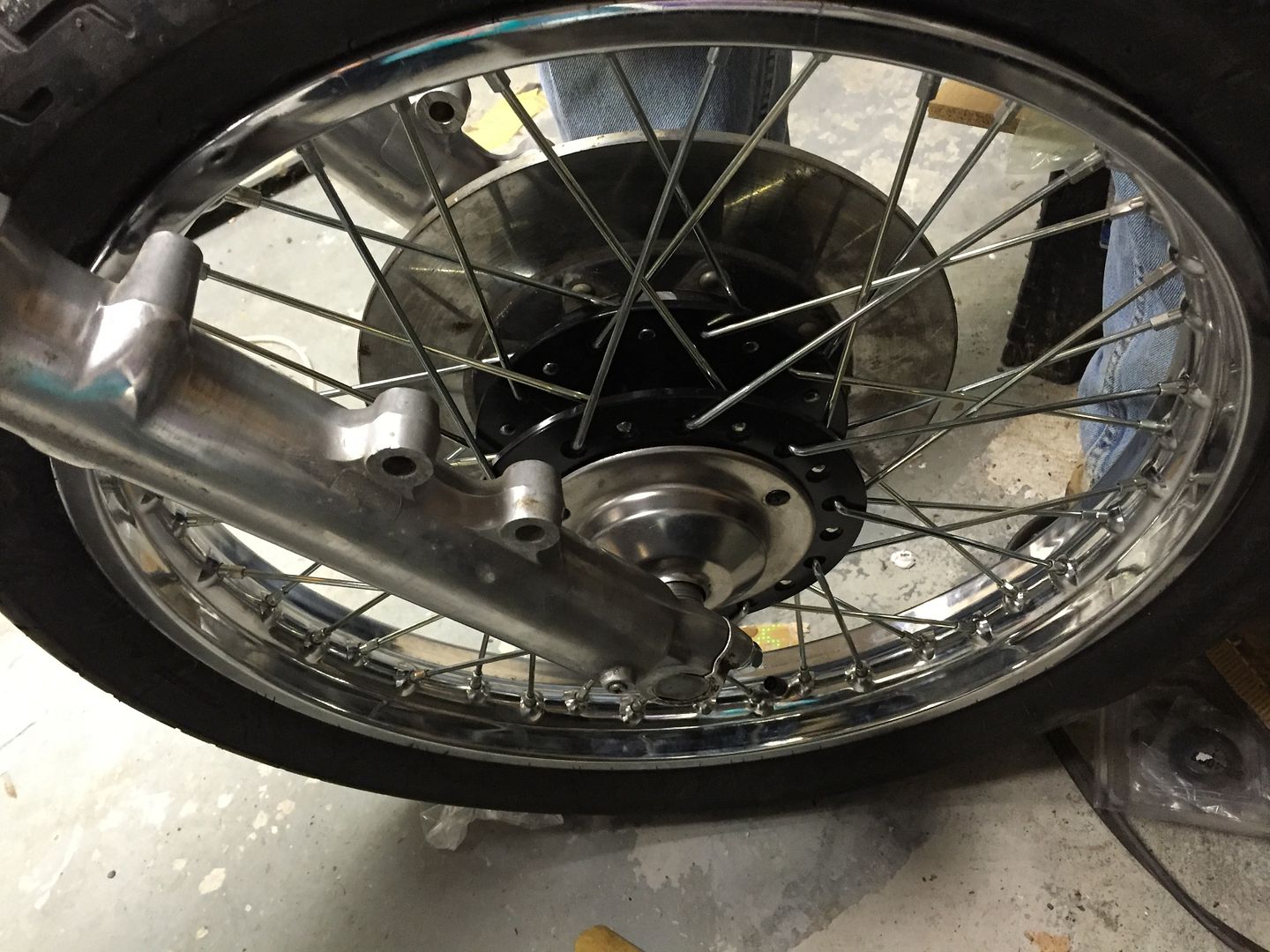

Front has new spokes, bearings, seals, ect.

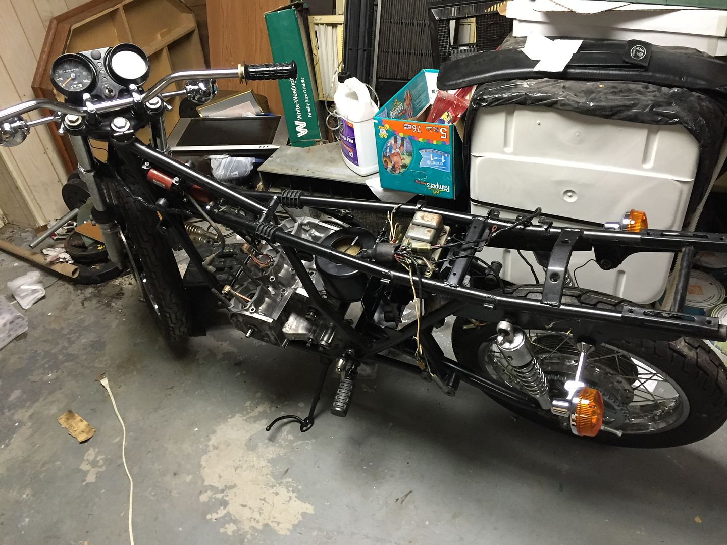

As it sits currently. :thumbup: I'm hoping to be picking up my powder coated chambers this week. Moo has my cylinders for bore and will be throwing a reed kit on it. I still have a ways to go but I've got a good start on it. i hope to hit it some more over Christmas holiday. :thumbup:

So far the Z1/kz ears don't look too far outta place. My H2B came with ears that need rechromed, I was looking at kz ones for a stand in
PostPosted: Mon Dec 21, 2015 10:51 am
The Z1 bits look fine on the bike. You will have to remove about 1" from the bottom but other than that, a straight forward fit. If you go that route, I wouldn't cut the ears off to match the H2B ears if you are using the tapered head bearings. Those bearings space the trees a shade further apart than the original bearings do. Its best to load the triple trees with the bearings in place, rotate the top tree far enough to slip the Z1 bits on, load the ear on upside down, and rotate the ear around the shock tube and sharpie a line around what needs removed while rotating the ear. These came out perfect without the need of additional rubber washers. :thumbup:

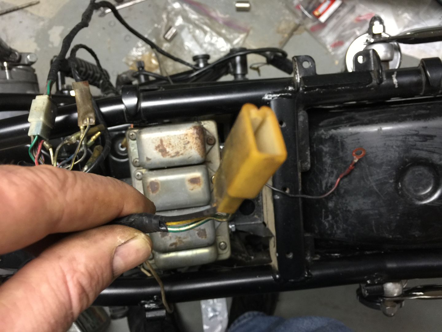

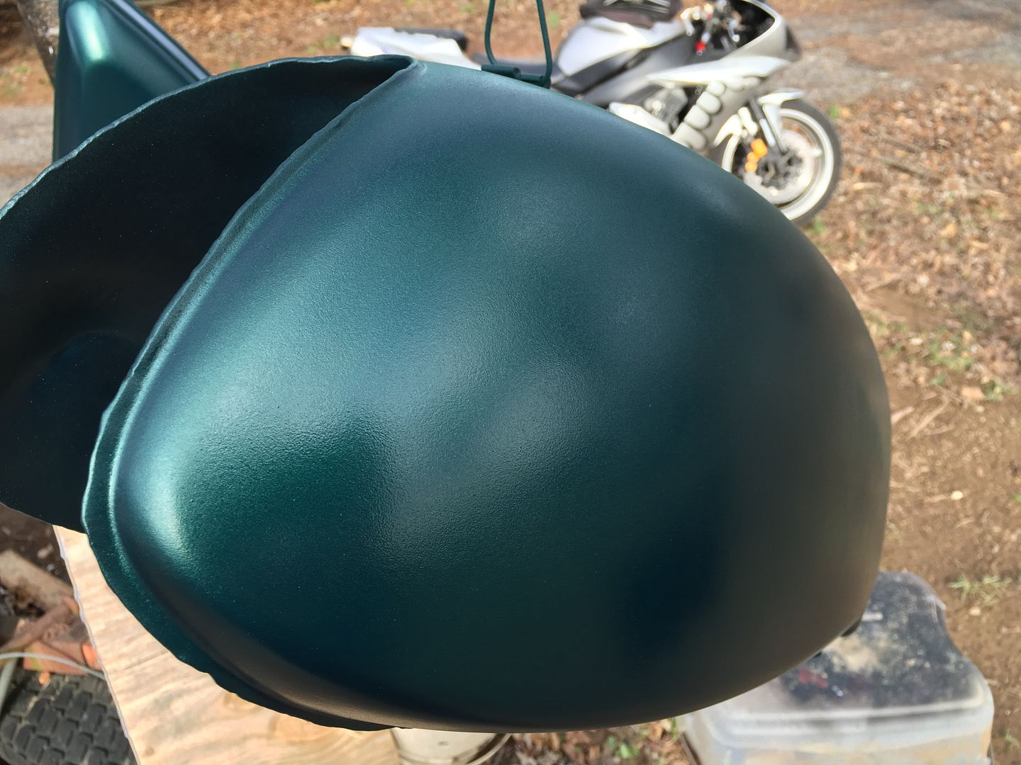

i thought you all might like to see the paint choice. I do have a question though. I've been going through this wiring harness trying to figure out all the connections. I think I have a connection for everything on the back end but the plug in the picture......I can't seem to figure out where it plugs in to. :eh: I looked at the wiring diagram but the only 3 pin plug I see if for the meter lights, but this one is on the back end of the harness. Anyone know where it goes? looks like the regulator plug you find on the S3.
Oh yea......whoever sold me this gas tank for a song......the tank in the pic is your tank. I appreciate the great price you gave me on it.
I got a call from the powdercoaters............the chambers are done. :thumbup:
PostPosted: Wed Dec 30, 2015 4:22 pm
Posts: 2825
Cant remember for sure. Brake light out indicator maybe???
PostPosted: Wed Dec 30, 2015 5:48 pm
I bet you're right. It seems I do remember a small rectangular electric box thrown in with the loose stuff. Thanks for the tip......ill have to start rummaging. :thumbup:
PostPosted: Thu Dec 31, 2015 4:10 am
Joined: Sun Sep 06, 2015 6:01 am
Posts: 335
Location: Metamora, MI
User,
It looks like the brake light failure module plug.
The mod looks like a small rectangular rubber coated 3 wire contraption/gizmo.
Nice bike!
