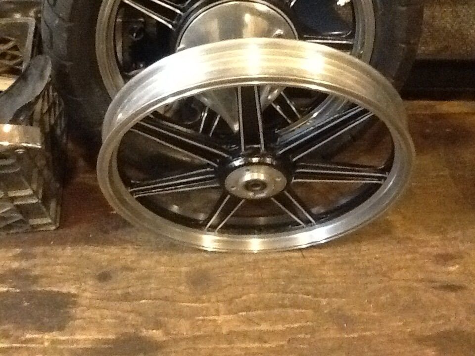

I just did mine that I recently purchased, the rear had the silver spokes and the front was black spoked.
I carefully used a Dewalt orbital sander with 220 grit and sanded the spoke edges, then finished with 1000 grit wet sand.. I used semi gloss spray paint, that I sprayed in a the cap and brushed on by hand. I masked of and sprayed the rear all black like Jim suggested I just preferred the extra bling and some more gloss on the spokes when I was done . So I basically did them twice, it took two weekends to get them how I liked them, I know that they are not stock resto but that's fine with me.. I found it was easier to paint by hand with a small brush to get in the low spots of the spokes and control the paint, if I did make a mistake i just wiped off by hand and kept going ..

How did you get a nice edge all the way around the black inset center? Tape?

Just used a 3/8 or so hobby paint brush I got a the paint store medium stiffness.. Just put the rim up on the work bench sat down and picked away at it .. Can cut in surprisingly well with those little brushes. I didn't sand any of the rim surface just the spokes ,that would of been another project in itself..

Man, those look really sharp !.......same way as painting the "Kaw" in the side covers.......carefully I guess :clap:
Those are some really neat wheels, and period correct, true and straight as being cast
THX Phil :thumbup:

H2's never disappoint. Yours is dailed in bro. Just what I needed to get off my arse and keep working on my roller. Definetely do some rides when it gets warmer. Took my lesters to work today, I figure if I look at them all day long I will gussie them up. d
And thank you Johnny O for the lester pics. Mucho helpful.
