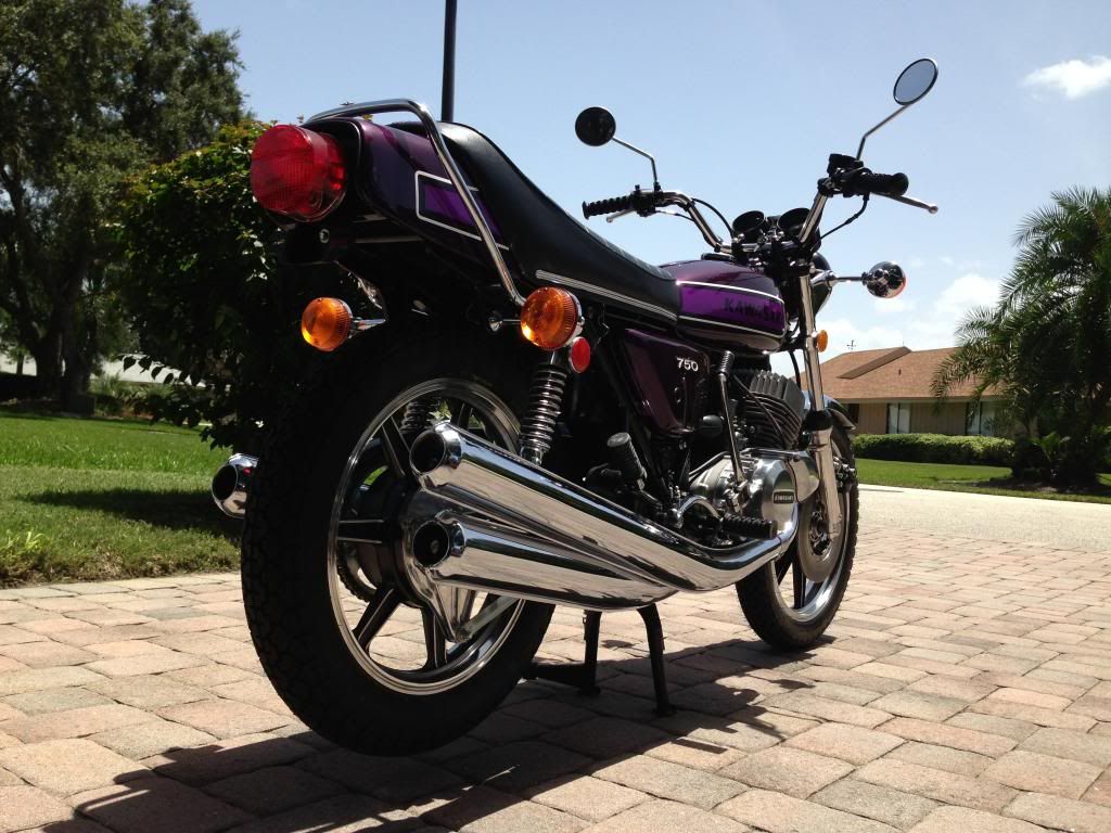

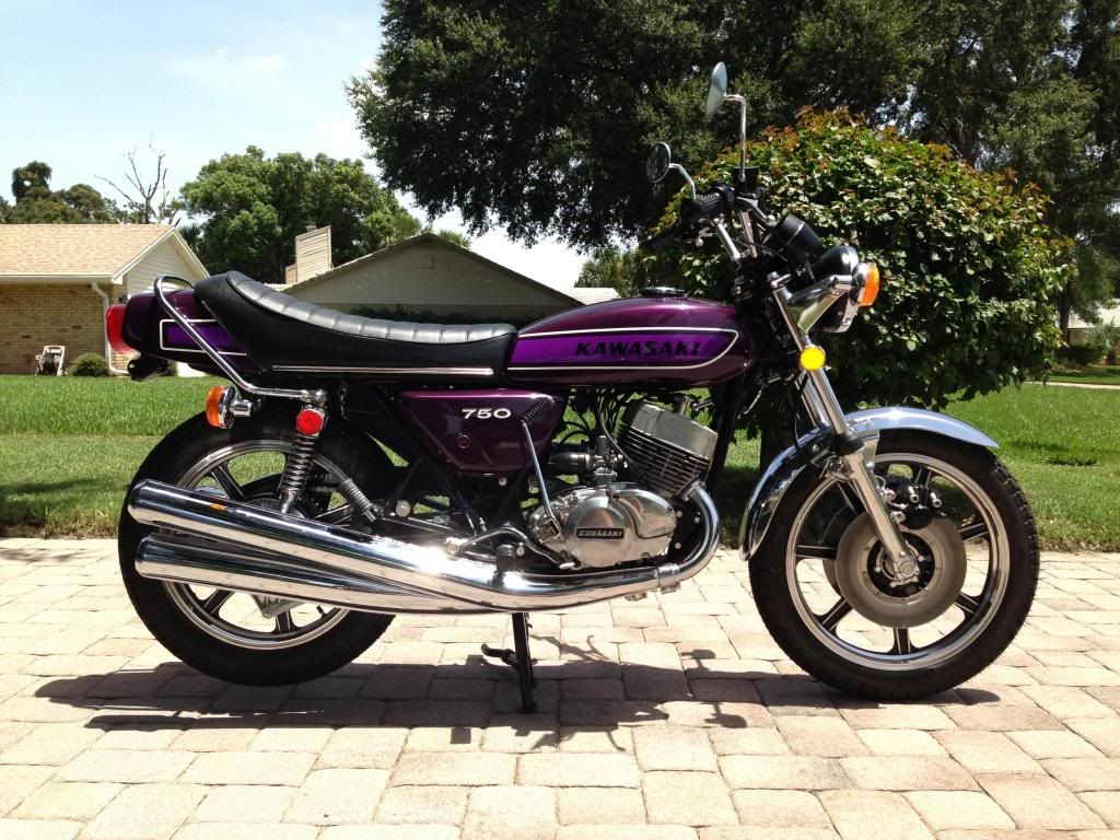

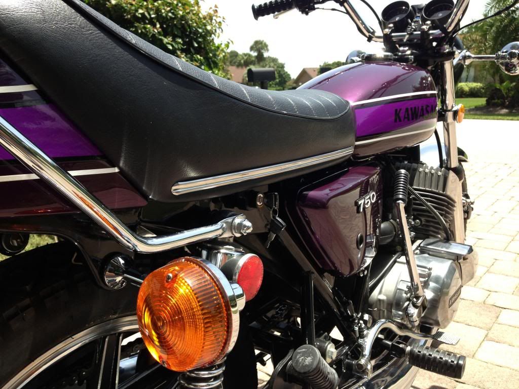

Nearly finished....low speed coil to replace then get her running.

BEAUTIFUL job...I'm glad you ended up finding a nice set of those hard to find Lesters, not to mention the dual-disc set-up. Is that an oem rear grab rail, or one of the nice repros from John overseas (from Jess Bikes perhaps)?

THAT was a low ball! :P You KNOW it is a repop! :roll: . . :P . (Grab rail has to go Steve!) Good job! ! ! ! ! Nice paint as well, Wheels look great - go to the top of the class! :thumbup:
