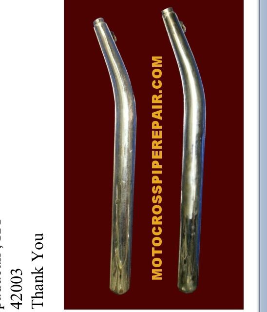

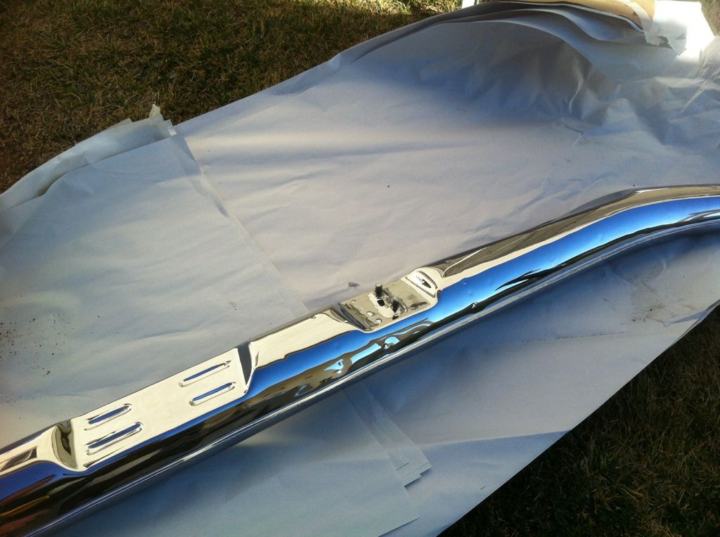

Going to send one pipe to Bruce at motocross pipe repair, before re chroming.
PostPosted: Mon Dec 30, 2013 11:36 pm
Posts: 849
Location: Monterey Ca
3 weeks later, did not say to rush. dents repaired, $65. Now from there to brown's plating.

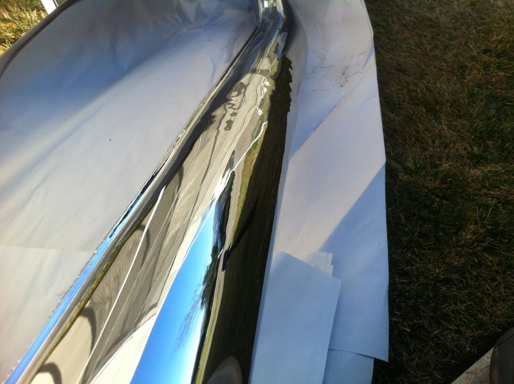

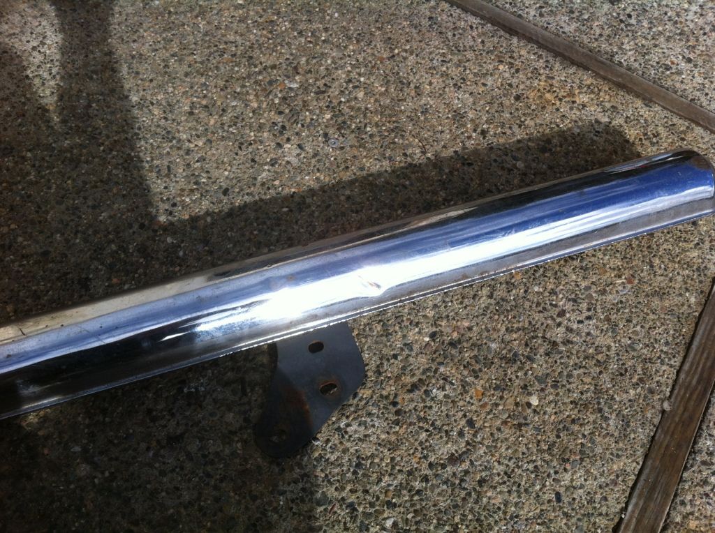

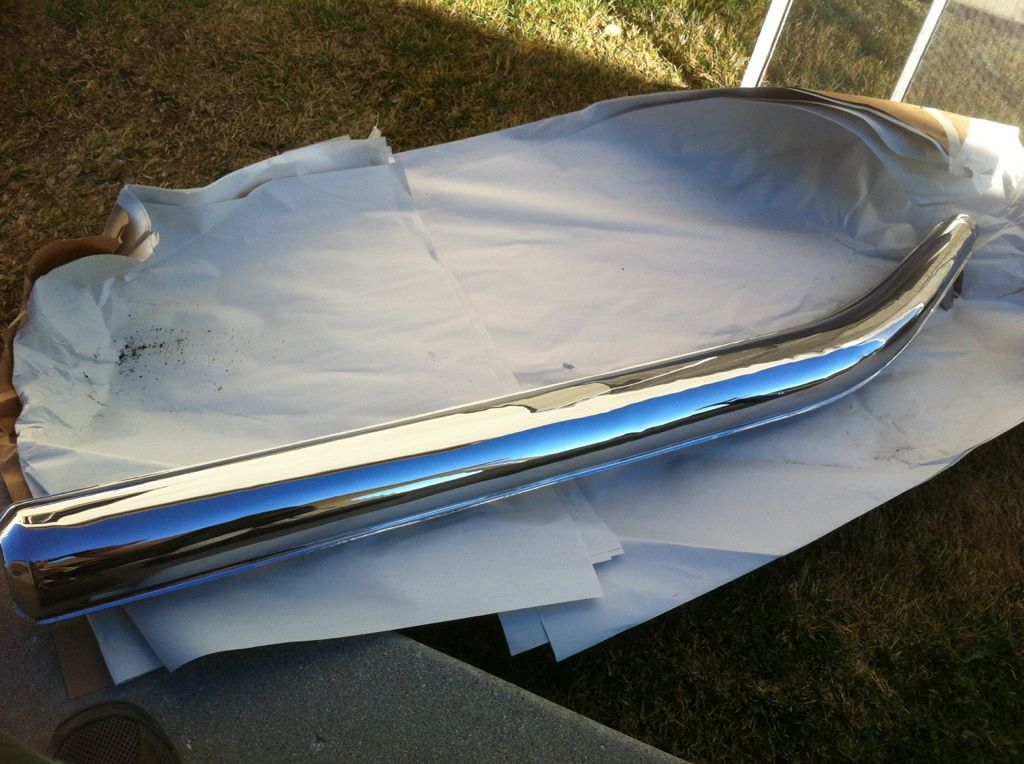

Got the pipe back from Browns plate. The chrome came out great. Motor cross pipe repair removed the the dents and scratches. Repaired areas much improved, but wavy. Probably only so much you can do with heat and air. Nice chrome maginifies any waviness.
