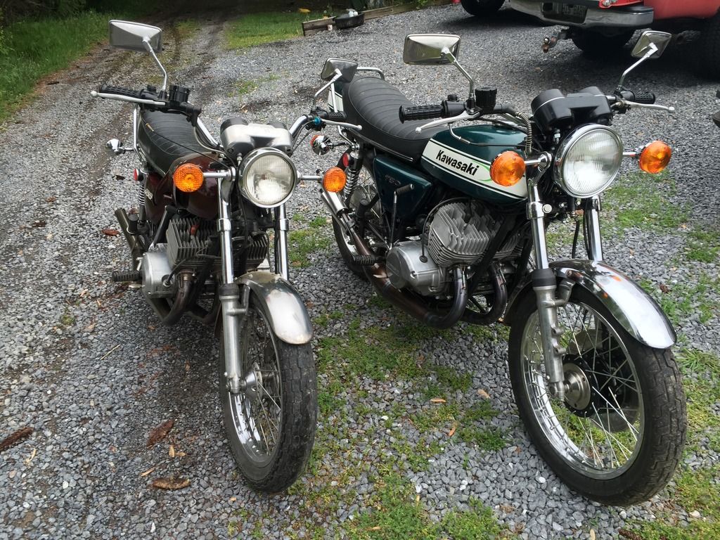

Seems some massive intake leaks resulted in the first set of pistons being taken out, but she's all fixed up now. :thumbup: Still need a few small things done or changed out but for the most part, she's together and runs, considering what kind of basket case I had to work with. She runs strong and is plenty fast. It isn't perfect by any means, but it's nice enough for now until I get to the small stuff.
Bill, that head......was it meant to have a helicoil in it or was it bored out for a bigger plug? Plug hole has been drilled and rethreaded. :eh:
I tell ya though, since I've been running it around here, I've been stopped and asked about this H2 about a dozen times. I took it over to twiggs bike shop Wednesday and I wasn't away from it for 5m before a group of guys that worked there were circling it. I've even been asked if it was for sale once. Not on your life, sport. :lol: they want me to bring it over for open house and it may make another appearance. :thumbup:
If anyone is looking into the k2tek chambers be warned.......hitting deep bumps with the front tire will make the fender hit the center chamber sometimes. :thumbdown:
The s3 now has a partner. :thumbup:

That looks great! A lot of work in that project - and another H2 comes back from the dead!!
I had FPP pipes that hit the fender. It was very dangerous under hard braking into a turn - the bike wanted to go straight. I fixed it by grinding the end of the pipe where it contacts the manifold..you can gain an 1/8 to 3/16 this way.
