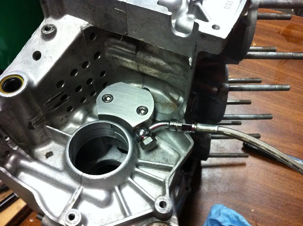

Another option is available from Redline Motorsports in the form of an aluminum spacer that positions the ball bearing release outwards the distance of the added width of that type of release (shown beside the seal that Dew refers to).

My next tear down is the seal and then I can get rid of the spacer I made (and the adjuster bolt I made like in Moo's video).

You can take our special clutch release and you don't have to change anything. It fit's every model
and works great.

.....and it works great! I have 2 of them, very well engineered product!
PostPosted: Sun Apr 13, 2014 11:06 am
Nothing but good reviews of Ralfs acuators.
I decided to pick one of these up from Ned on the Canadian board.
$150 and you just need a master and brake hose.
