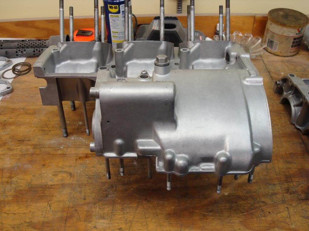

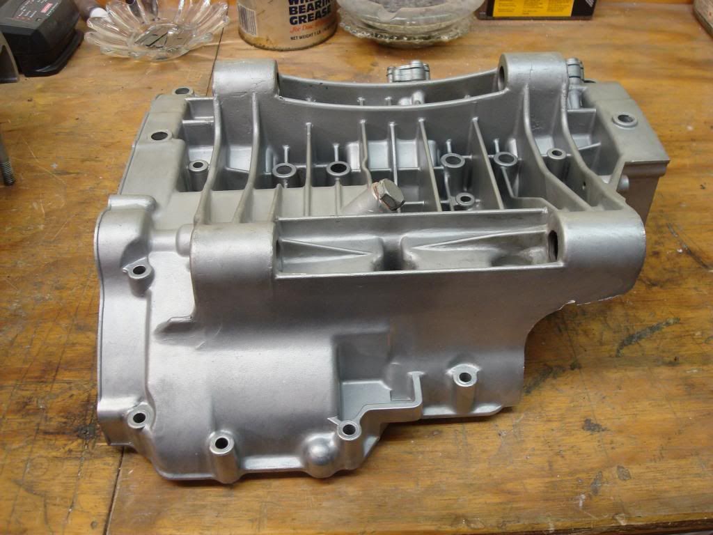

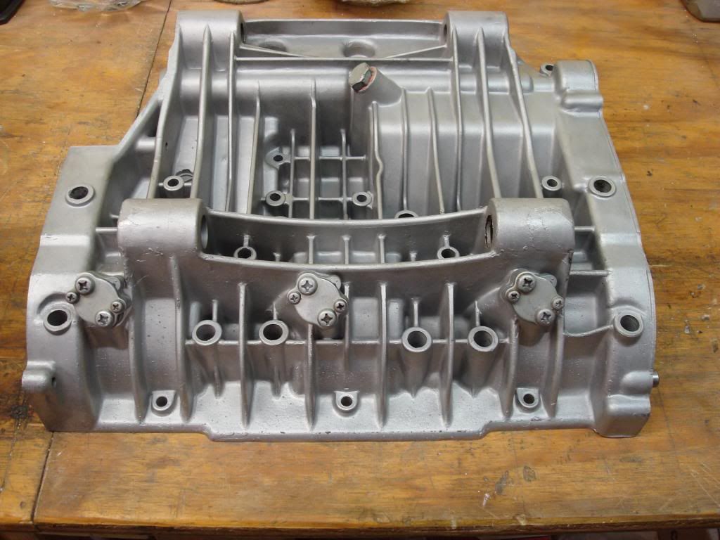

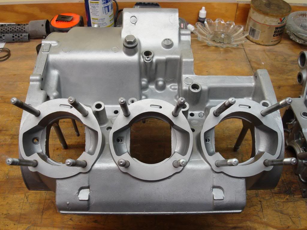

Did the cases today, soda blast for degreasing followed by glass bead and walnut. Used direct pressure blasting with walnut to knock down the shine and dulled them more than I like. I may try another pass with fine glass bead at low psi to brighten them up some. But have had enough for today.

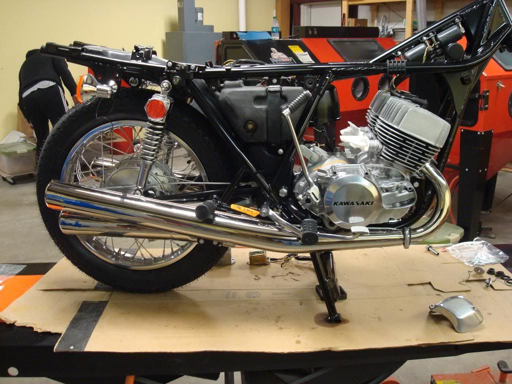

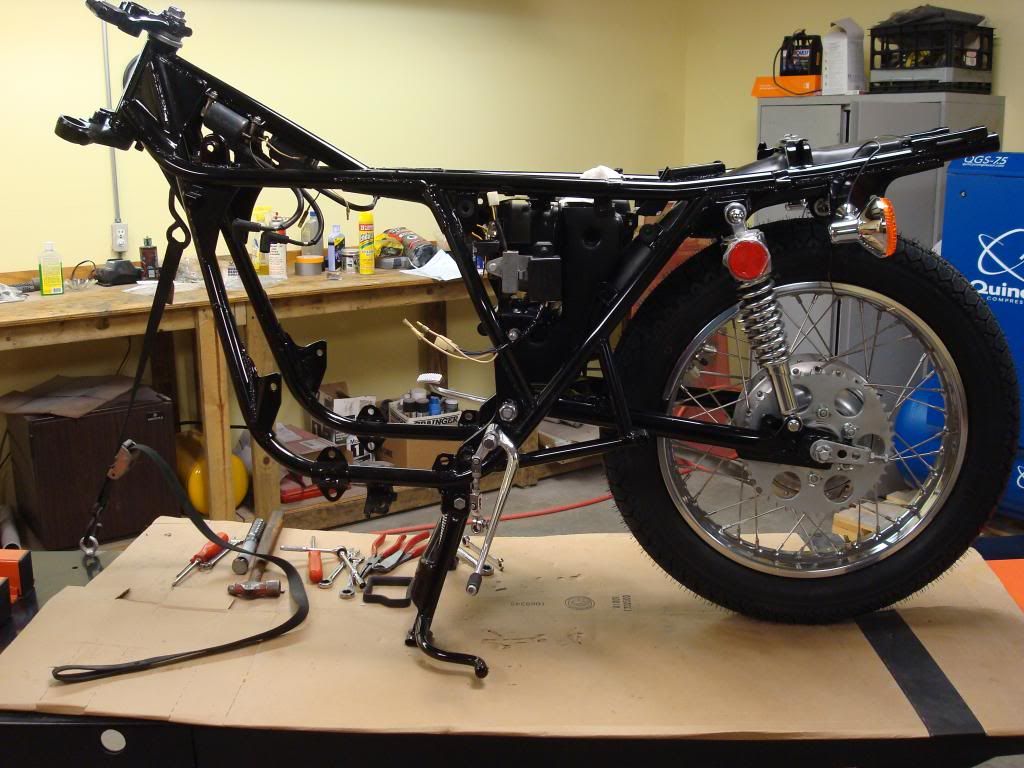

Got some more parts installed today:

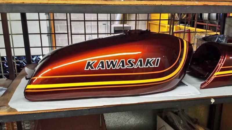

Got a teaser photo from the painter today:

I have a story about that paint scheme: I did a quicky refurb on a '76 KH250 and got a set of RB's decals to finish it off. Now the 250 decals are different from the 400 or 500 and somehow I received 400 decals (no white stripe). I wasn't bothered by that so proceeded to go to paint. The painter who is a bit of a detail nut called me and asked if I wanted a bit of kerning done between the "A"s and the "W" ...to tighten it up a bit and make it look better. I agreed not really worrying too much about it. Fast forward 6 months and the jolly old Limey himself walks through my garage. He comments ion the nice paint and asks whose decals I used. "Yours" , I said. To which he replied: "no way, the letters are too tight together". We are talking 1/16" here folks.
Gotta get up real early to hoodwink that guy.
