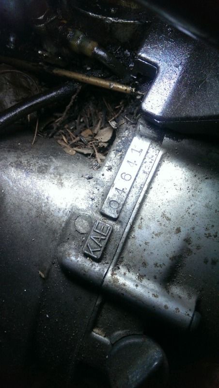

Took long enough but I finally got the third cyl off.
Image anyone know if this number would be considered an early h1?

I think any white-tank H1 would be considered "early".........(but, yeah, it's early!) :thumbup:

Yeah I guess I miss worded that one. I actually meant early for a 69.

Bingo! What a great find. :thumbup:
H1 1969 KAE-00001~ * KAF-00001~ Midnight White
H1 1970 KAE-06315~ * KAF-06727~ Candy Red, Peacock Gray
http://kawtriple.com/mraxl/serialno.html
Using these ranges as a guideline, KAE-04641 would be approximately 2/3rds into the 69 production run, granted your frame is similarly numbered (considered "matching" if "close" to your engine part number). This recent cancelled auction was for another 69 with part number's KAE 03675, KAF-04018 http://www.ebay.com/itm/191112556261.

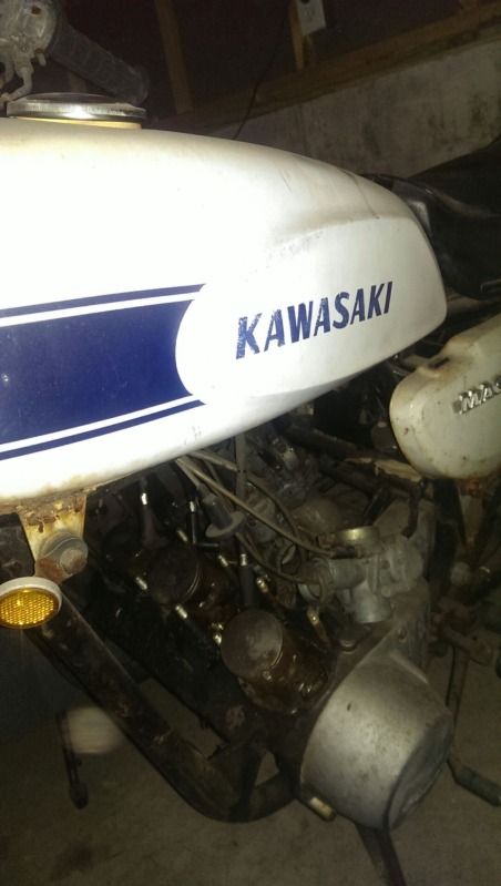

For comparison (not mine):

kawi3cyl wrote:
H1 1970 KAE-06315~ *[b] KAF-06727~ Candy Red, Peacock Gray
[/b]
That REALLY isn't correct :eh: - You won't find a sub 10,000 Red H1 ;)
O.K. Wheres that pic from ? That bike is my bikes sister - I have owned KAF-00184 for many, many years :think:

R.B. wrote:
kawi3cyl wrote:
H1 1970 KAE-06315~ *[b] KAF-06727~ Peacock Gray
Agreed Rick - just wanted to suggest to kawboy where his 69 fell in the "white" range. :thumbup:
