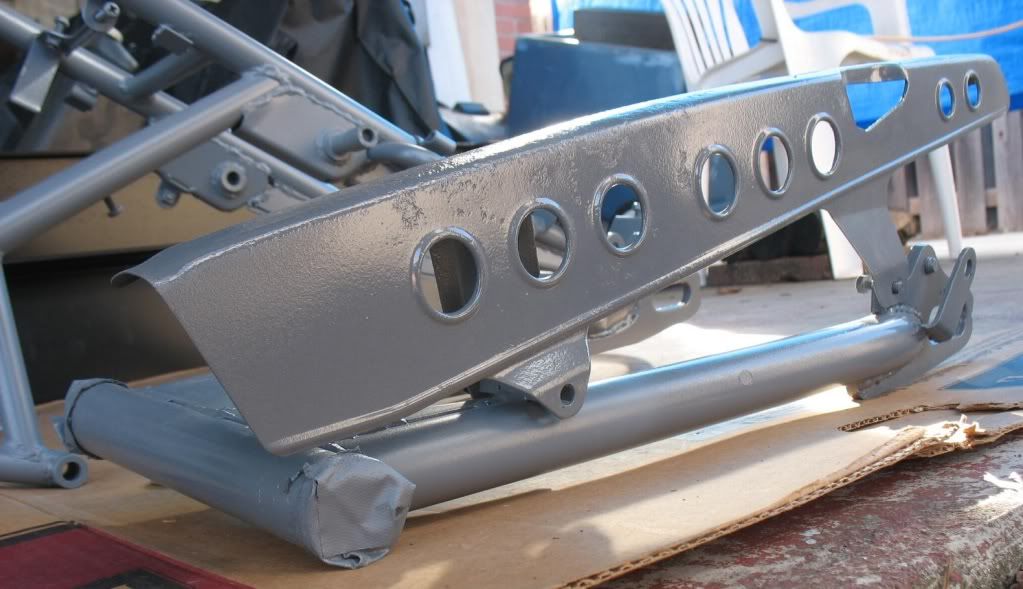

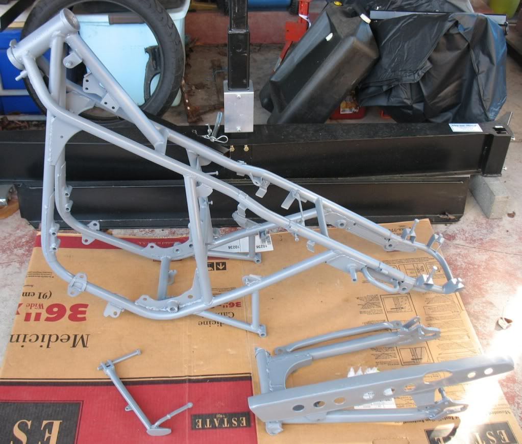

Yeah, it's easy to touch up running bikes, bolt on some Lesters and chambers, or even go through a motor (my H2C). That's the extent of my endeavors thus far...aside from seemingly always buying parts, and then extra parts off ebay that sit on a shelf collecting dust. So here begins my very 1st attempt at a ground up build, starting with a bare frame and related parts (not the one pictured in my avatar). I decided that instead of powder coating, I would just have a local shop media blast all the old paint and rust off of the main items, after which they spray a coat of epoxy primer atop http://www.americanstrippingsacramento.com/about.html. I chose this route because if I ever need to modify or cut any part of this frame, I figured paint would be easier to touch up. I picked these up yesterday(Sat), cost out the door $136.
Some pitting here but I don't care...it's intended to be a rider, not a show bike.

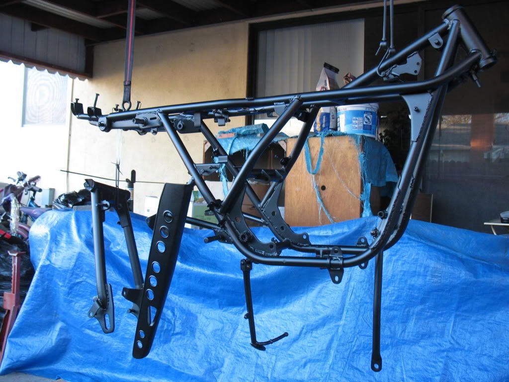

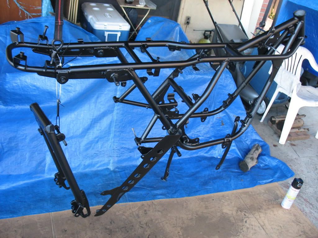

Today I lightly ran by hand an abrasive pad over most of the surfaces, wiped any dust off, and proceeded to rattle can everything semi-gloss, first starting with the frame, then hanging up the swingarm afterwards and painting that. The chain guard, kick stand, and brake arm I sprayed while holding up by a screw or bolt fastened to it. Then I hung them through the frame to air dry.
