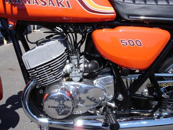

This is the "look" I'm looking for in my rebuild. I'm sending my cases, carbs, hubs, cylinders and heads soon to Arnold's.

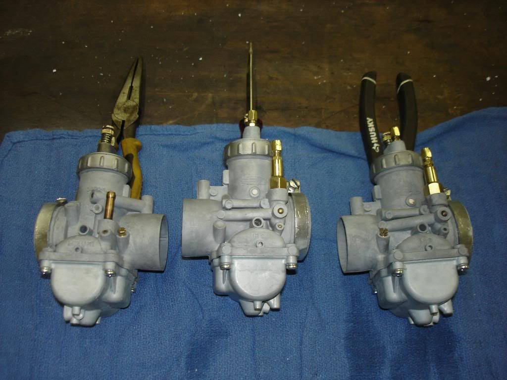

IMO carbs were never something that were shiny when new. Even a brand new Mikuni doesn't look polished or shiney. The best I have come up with is soaking over night in carb cleaner, rinse, then quick dip, (less than 5 seconds) in Muriatic Acid, dip in baking soda solution, thorough rinse. This is as close as I have come to a stock look. One problem, and it only happened once, was the bowls came out slightly lighter than the bodies?

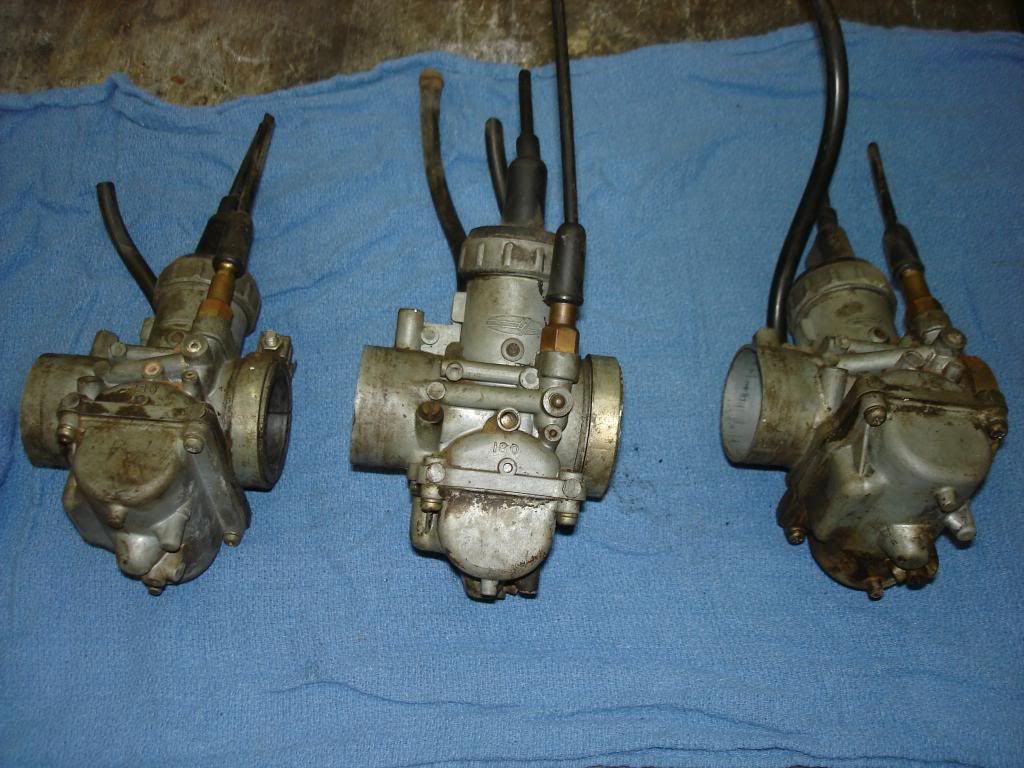

Some before and after of the method I use.
And here they are mounted on the bike. It's just my taste, but pipes can pop, paint can shine, and cases polish up like chrome but carbs should look clean and mechanical. For me anyway, they should blend into the look of the motor.
