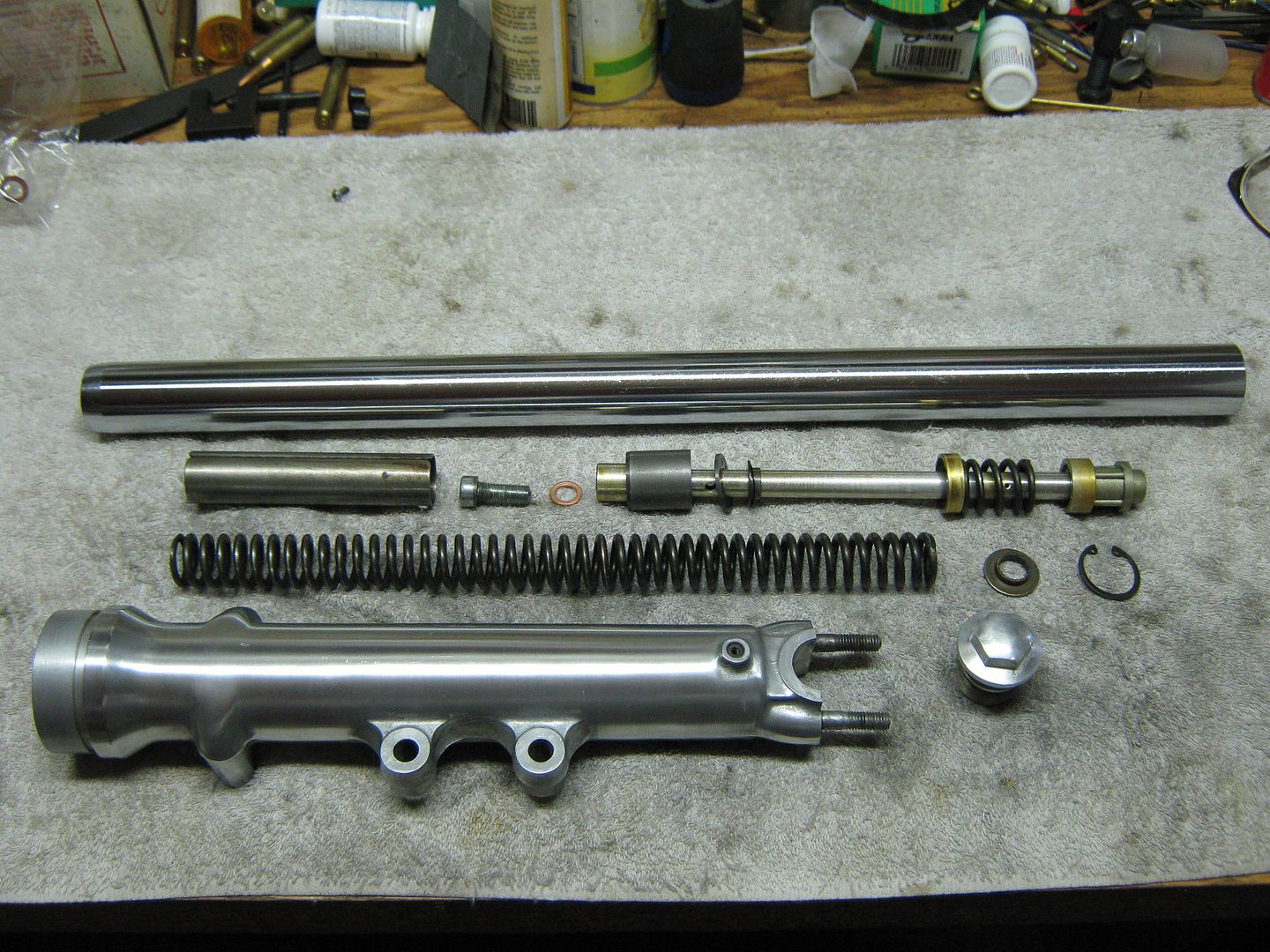

I guess I should have used a different word than polish. This is how I did mine.
That finish looks really good GUTS! How did you do it?

I just used 400, then 600, and then 0000 steel wool. I went around and round with the abrasives and not the long way on the leg. When I did it the long way the first time it didn't look right so I did it over. It's very simple and like the moo said "a coat of wax works wonders".

Here is my H1 lowers after bead blasting:
I used one of these, from Harbor Freight:
Then some Scotchbrite, to get this! :mrgreen:
It's just the finish I was looking for, close enough to factory but not polished. :wave:
