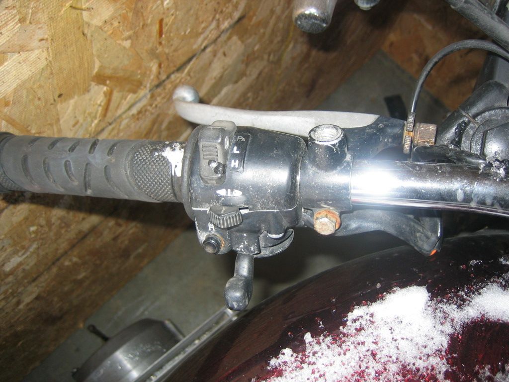

johnatkens wrote:
Those look great, I may try to refurbish mine but not sure I could get them to that level
John,
This is what I started with:
I doubt that yours are much worse. There is hope. :thumbup:
PM me if you want more details.
