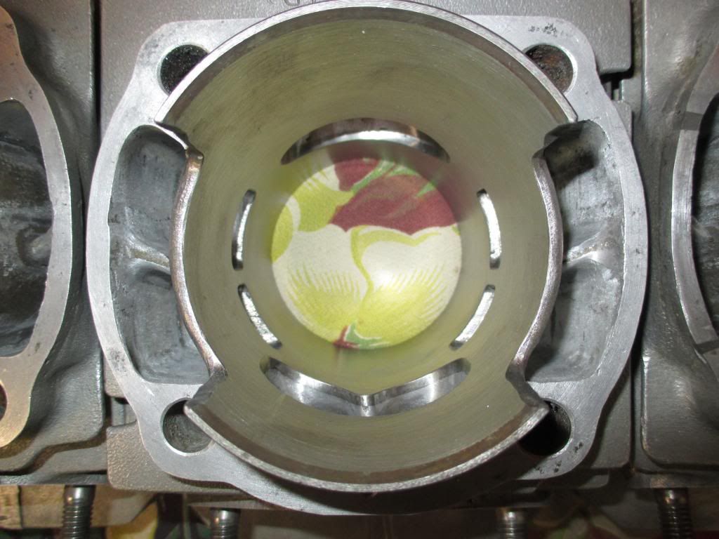

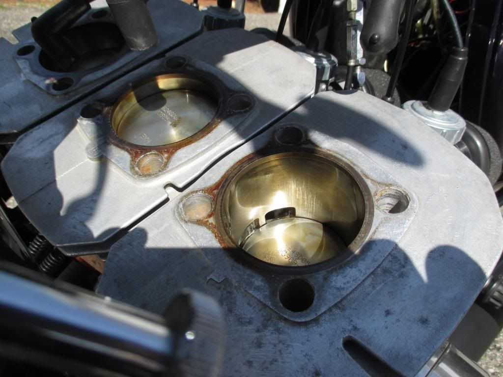

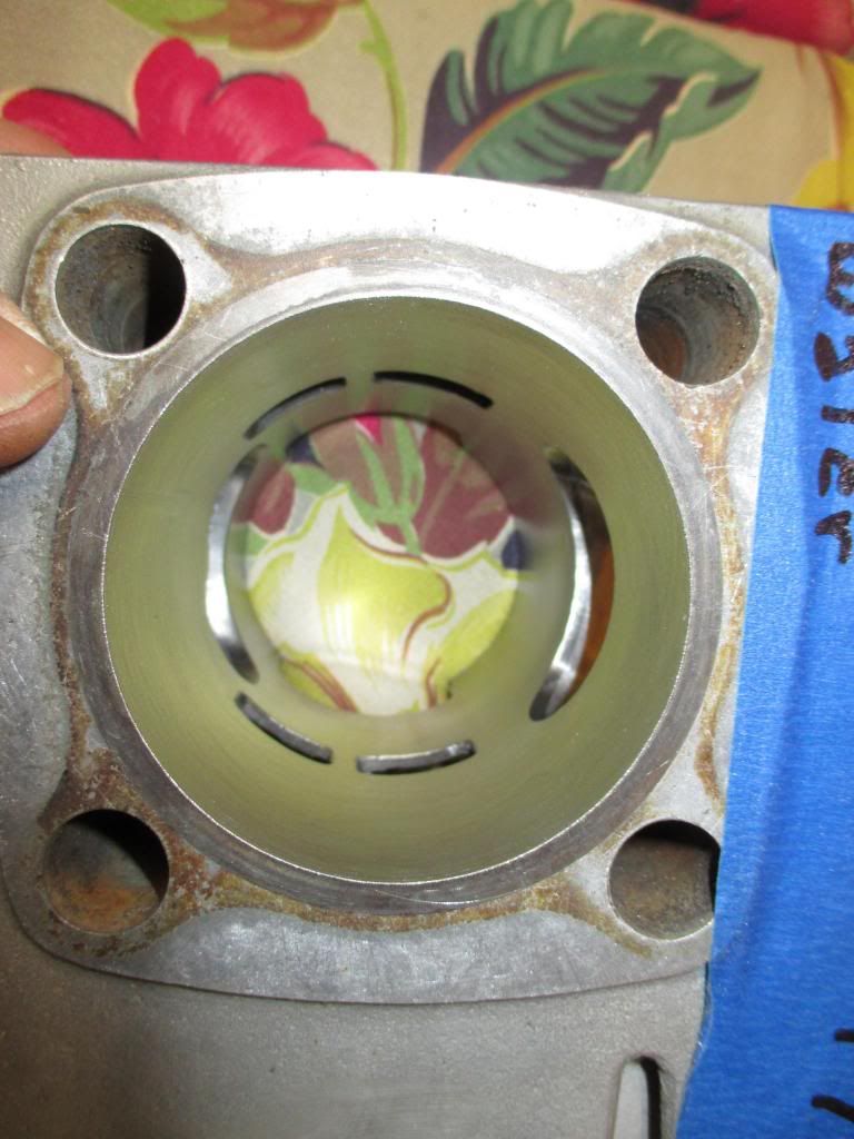

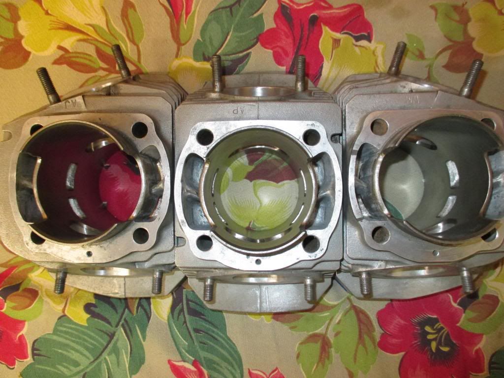

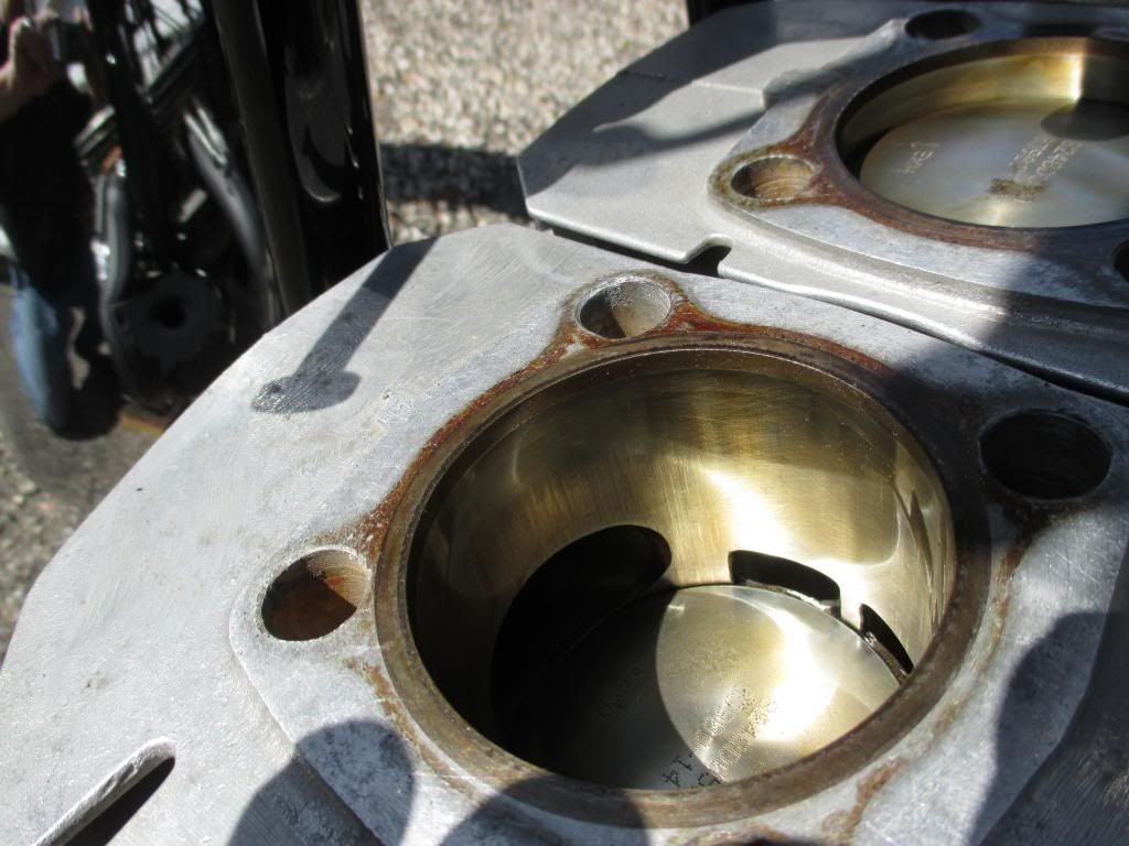

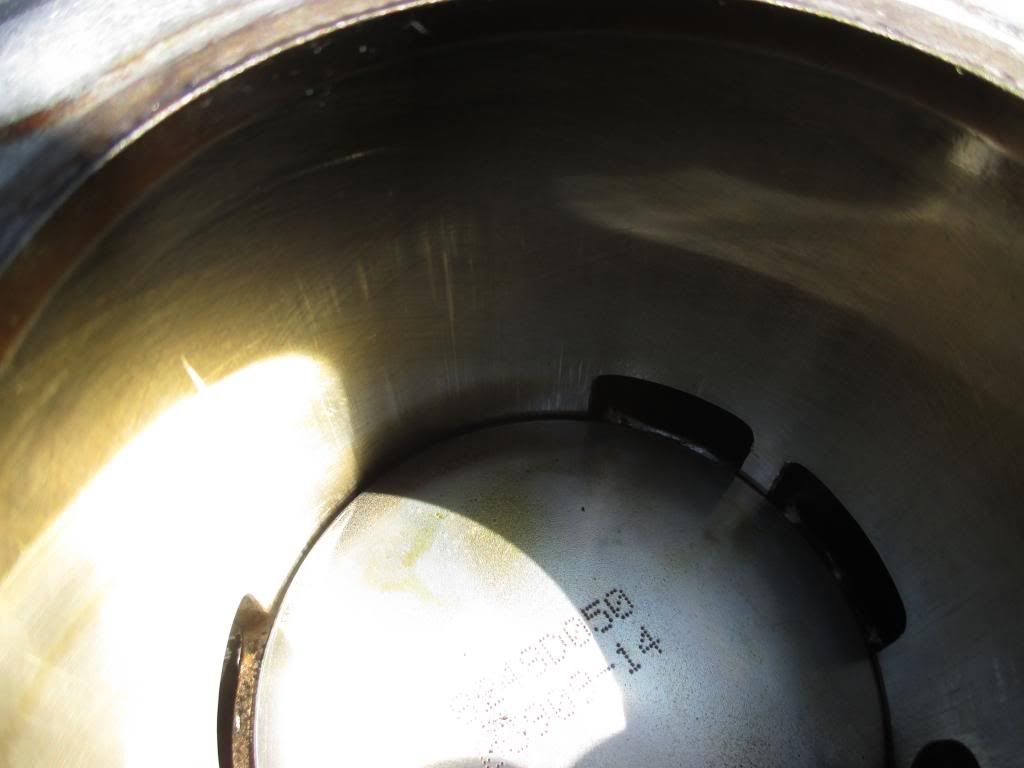

After spendin $1400 on new Wossners, Stage 1 Moo port and bored.......I took your advise and pulled the heads, anealled the gaskets and retorqued to 26 ft lbs.........the PIC's show some scratchs and wear as described :o .........also Moo's port work........Thank You Guys very MUCH !!! :wave:
